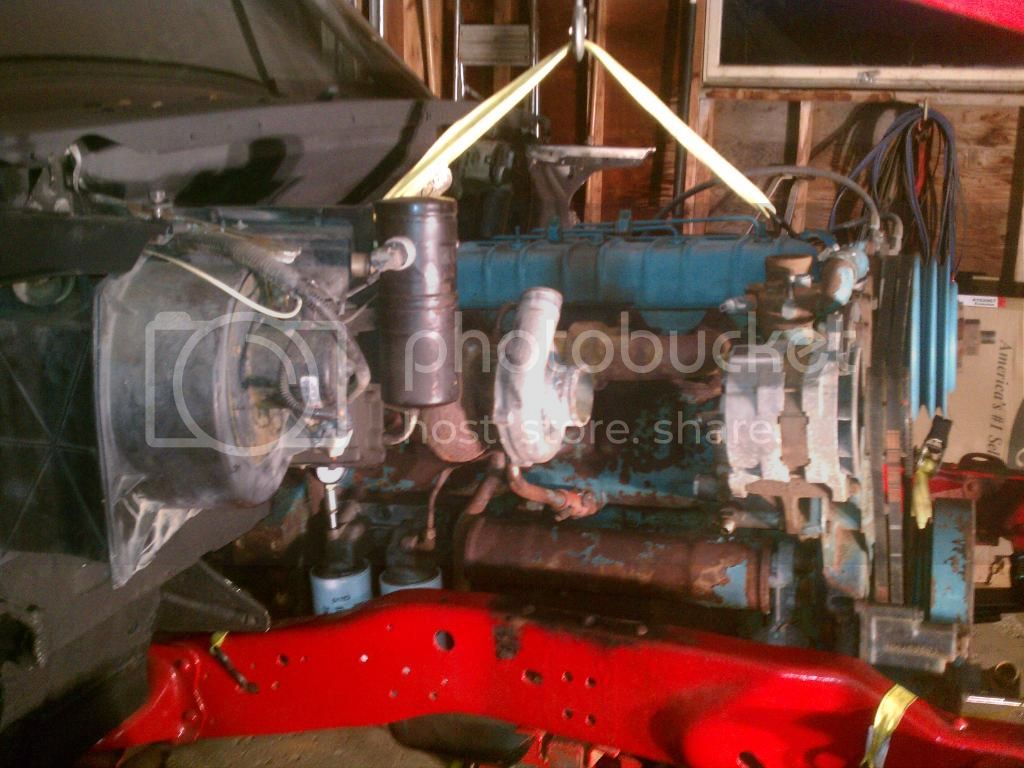

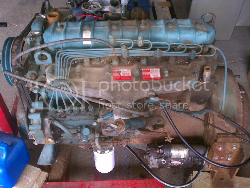

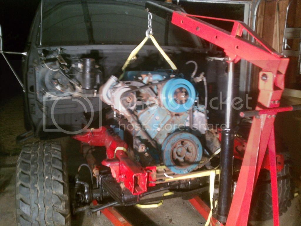

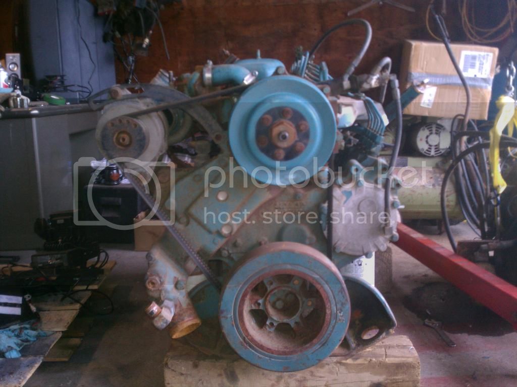

alright guys, been a while, but i made out on some good trades, sales and purchases and a dt360 now resides under the hood! will be getting a 5spd allison 1000 behind it, and eventually a built p-pump and compounds. you wouldnt believe what i picked up the dt360 for with a allison at545 trans!

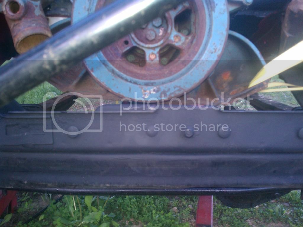

thats all i have right now. been insanely busy with work and the truck and house searching. im currently working on motor mounts and about to order my bellhousing for the transmission to get that in. lots of work ahead of me yet!

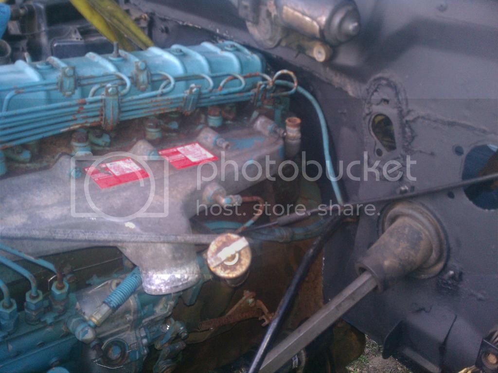

dt360 is cooler. its 1 cubic inch bigger then the cummins 5.9, and is a better platform. wet sleeved, 5/8ths head bolts that according to hypermax hold 300 psi boost and when its built ill have less then 2500 into it including buying it. also its mechanical and more reliable

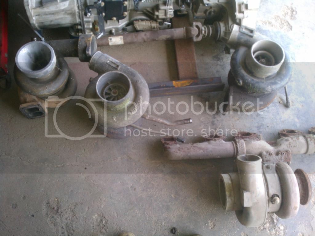

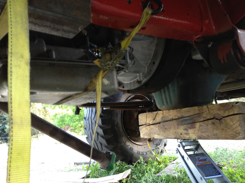

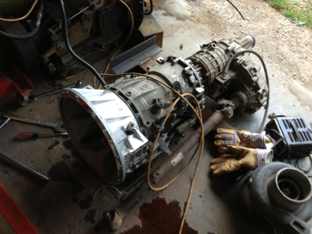

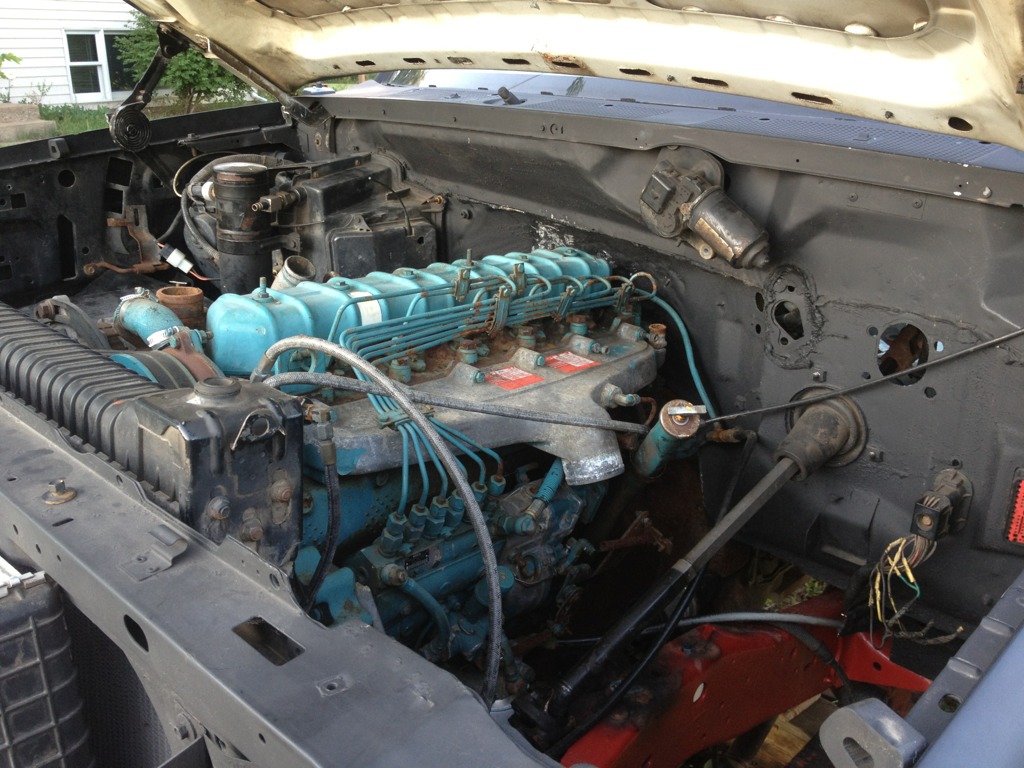

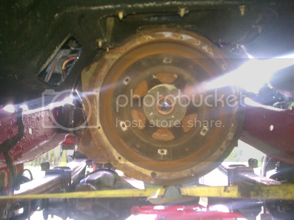

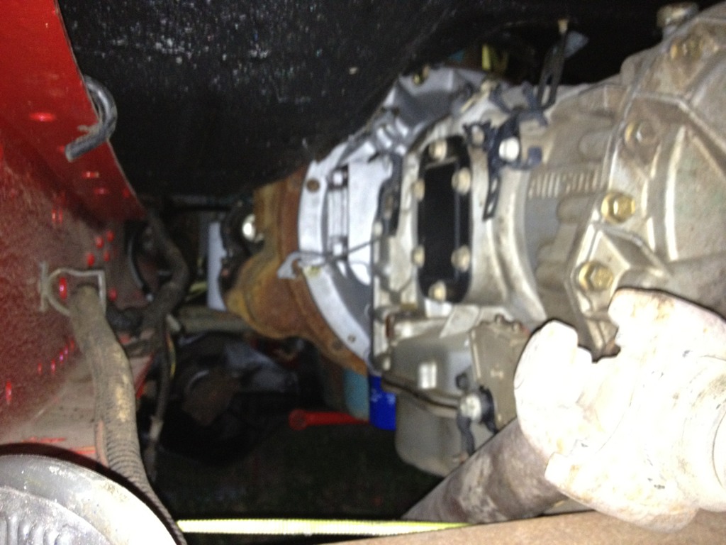

Alright, I know it's been a while since an update, but holy crap it's been hot out, and I wasn't about to be outside workin on this after working outside all day! Anyways, the allison 1000 is up in place. Used an allison 2000 bellhousing and it mated right up, no modification. I'm in the process of removing the a-pump and injectors. The a-pump is goin in as a core to the guy who is going to make my p7100 adapter plate, gear, and set me up with pushrods and valve springs. The injectors and my p7100 are going to contagious diesel this week to be modded as well! I'm looking for an hx50 to use as a primary with my ht4 still as the atmosphere. Going to be getting driveshafts before too long as well
