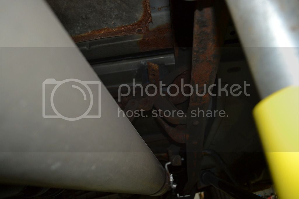

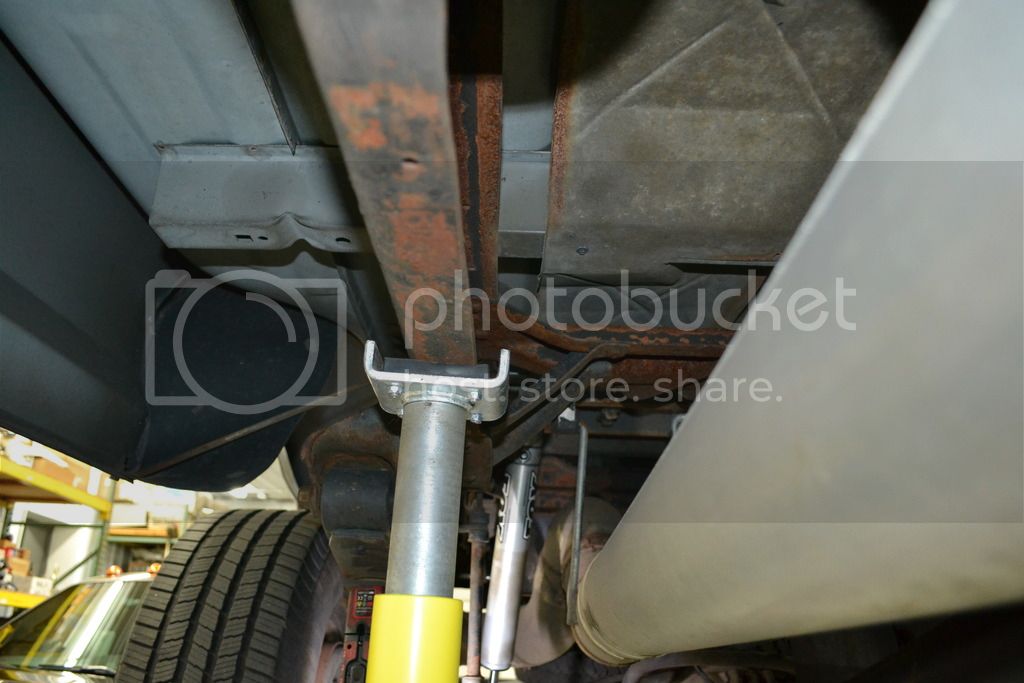

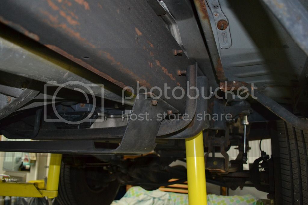

Did you guys make a brace to tie the frame by the radius arm mounts together? Also, do you sell those shocks with the special valving?
On my OBS, there is a crossmember by the front fuel tank and the trans crossmember. Both crossmembers have brackets coming off them going to the frame flanges.
Billy T.
[email protected]
Here are some pics of the crossmembers on my OBS and trans crossmember.
If front of the rear shocks
Right after the cab
Trans crossmember

the 2017 250 and 350 have fully boxed frames. i bet no more hop...
Arconalloy
Jul 29, 2014
372
Warner Robins, GA
Yea probably right ^^^, I want to get mine situated but I just don't see all that crazy bracing like that completey necessary but I've been wrong before
Layson
1,638
Yeah I don't think the bracing will get rid of the hop. That may improve slightly the handling but that's it... the frames are plenty strong in these trucks.
