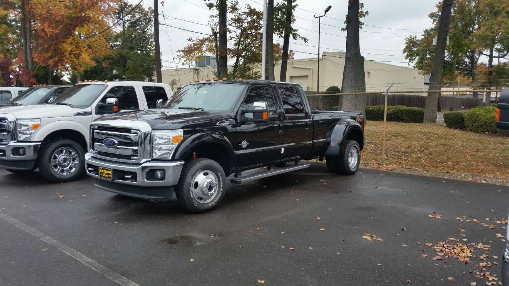

I drove it out of the dealership on Oct 30 and have driven it probably three times. I have 499 miles on it. Sometime I wonder why I bought it.
I have not felt a hop nor have it been paying attention for it. Never knew about this issue.
I have the truck on the lift to paint the rusted, bare metal parts (driveshaft and steering components). Hopefully the Rustoleum doesn't affect the balance on the driveshaft. [emoji10] . I'm also replacing the Ranchos with Fox 2.0s.

I might have missed it but your dually is a CCLB right?
