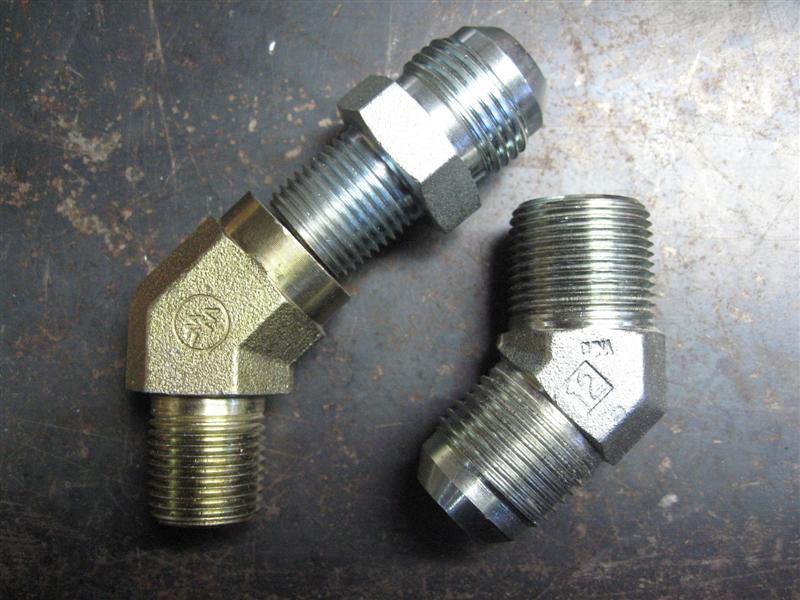

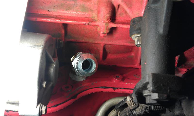

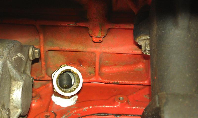

I had to use an adaptor in the upper oil pan plate, because to get the fitting in far enough to clear the lower oil pan, the fitting would hit the side of the block when I tried to insall it.
