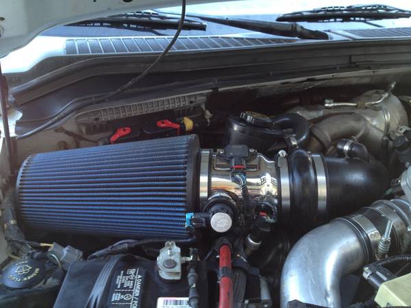

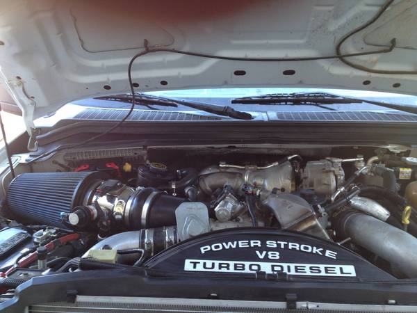

This intake is aimed at those with issue of pulling in the filter minder. Utilizing the AFE Pro5R, with and adaptive 4-5" polished stainless tube. this unit will work with stock turbo's, all replacement turbos ie: tow powers,industrial tow,rcd and swamps crossbows or/and any atmosphere turbo that remains in stock turbo location.
After testing, i cannot move the filter minder more than a 1/4-1/2" with high powers and 110's, this is definitely the best option i have found so far. Thanks to mike settlemire for the design assistance.
as of now the kit includes the filter, the tube, the maf plate, the filter minder location with updated grommet. soon it will include its own custom silicon elbow, and im working on a sheet aluminum airbox.
this pic shows the s&b elbow but it works the same with the factory elbow.
