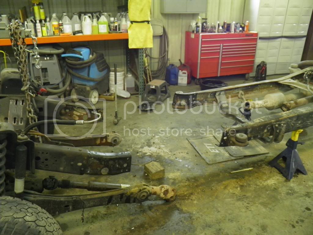

I am working on the ground work to do the same to my excursion but I am using a 7.3 to make the project a lot easier. I have a wrecked white ex cab in my shop now to strip down to do the conversion.
Going to follow this to see if I missed anything in my planning but prob will not be starting my project for a few more months.

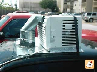

I agree with JD, roof AC would make it a winner as long as it's PTM. LOL

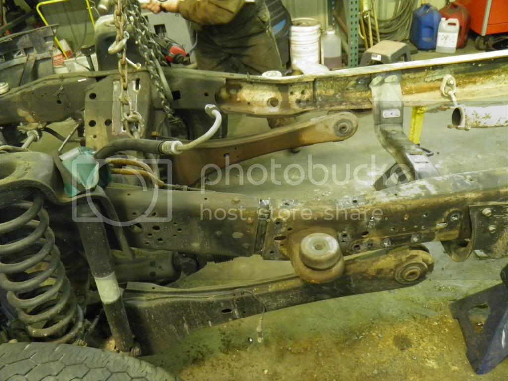

Seth: Why are you using the '05-'07 frame horns? I figure you would do a 6.4 or 6.7 frame horn deal to fit the newer front clip. the '05+ suspension will bolt right up to your existing frame if that's the goal. On the exhaust, I will likely do a 5" system designed for the truck. I will have a lot more room behind the rear axle than the average excursion as the RR shock will be in front of the axle instead of behind it.

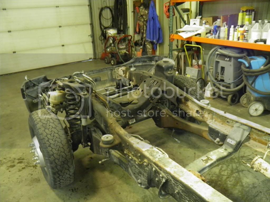

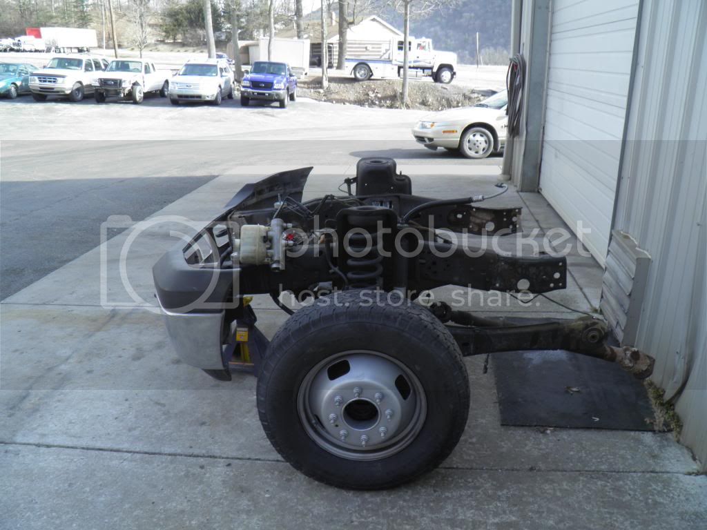

Actually just building a 07 F250 ec/sb 7.3 6sp out of the frame.
I wanted to post a few pics and then compare when you do your conversion to the 08 frame.
