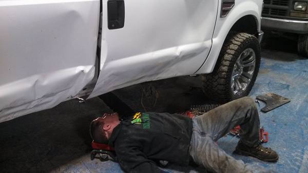

Pulling the trans and t-case tonight. Engine will be first of next week. Sure wish I had a lift to just pull the cab out of the way. Oh, well. With the drive train out of the way, it will be the perfect opportunity to graft the frame, and paint the inside of the firewall. Man, I gotta choose a color soon. This should be a fun little grocery getter for the wife since it will be getting the drive train from the red truck. :evil
