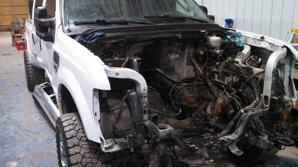

Another baby step in the right direction. Just before I bought the truck, the previous owner had new up pipes installed. Too bad it wasn't until everything got a thick coating of soot. There is a lot of cleanup in my future I think.

I can't tell from the pics, but did you just join the frame and weld it end to end with no overlap? If so you might think about reinforcing that area.

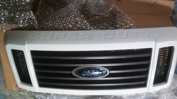

Unfortunately it'll be after valentine's before I make much headway. I'm headed home for a week on Friday morning, and still have about 20 hrs worth of work to finish before I leave. I will be ordering the grille next week, but that's about it. Going with this style pictured below though
I hope to have the excursion frame to the shop when I get back as well. that's a big hang-up for now. Matt: as far as the frame graft goes, I'm hoping to splice it at the factory joint behind the frame cross member, just like the factory does except for grade 8 bolts instead of rivets. If that doesn't work, I will do a large backing plate with plug welds and bolts. It will probably be stronger than factory whatever I do. The pics you've seen of frame work are of other people on different vehicles trying to illustrate their approach.
