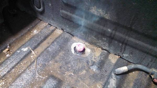

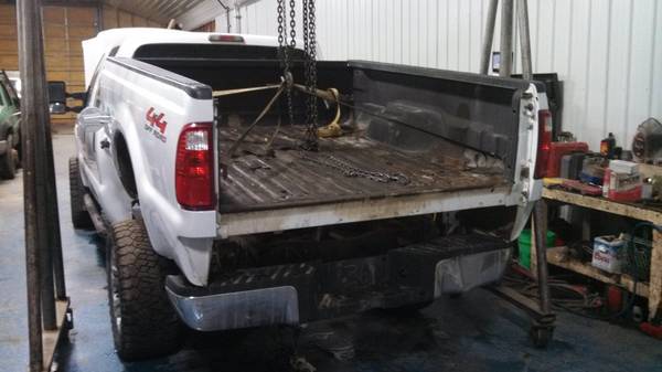

In other news, I got the truck back in the shop to start prepping what I can. Tonight I will have the bed off, but that's about it. before I started, I had a discussion with the bolts in which I informed them that one way or another, they were coming out. They chose another way :( by the time I made it to the 4th one (heating up the nuts from underneath to soften the factory loctite) my super fancy high impact snap on T-50 rounded the tips off, and I was forced to weld nuts on the tops of the last 5. I forgot what a pain these bolts can be until tonight.

We usually cross cut the heads and chisel them off. Welding a nut on works good until the nut on the bottom breaks out of the clip :doh:
You gotta love good ol road salt...

A couple of mine did that too. I had to weld them back on. Maybe next time I will take the cut and chisel approach. I probably would have if the ones above the fuel tank were beasts. Bed is off, but I had to get a little creative as I'm flying solo tonight, and a fork lift would be too awkward. Got 'er off though.

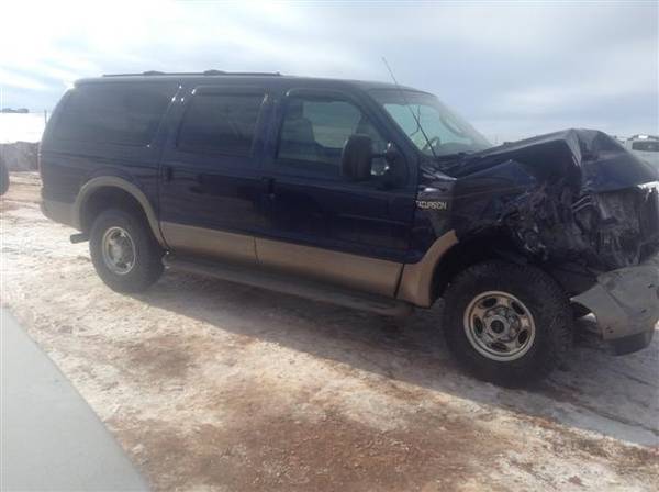

Well, I just bought a new project donor. Here it is:
This one's an Eddie Bauer 6.0, so I plan to use the drivetrain from it, throw in some head studs exhaust, tuner, gauges, and an EGR delete, then install it in my tan one. Then the body and frame from this one can be used in the 6.4 conversion. Now my wife won't have to be without wheels, and the resale value on the V-10 will go up. Once both are done I can sell the 6.0 to recover project costs in the 6.4. I'm about to go on days off here at the end of the week, so nothing will happen until I get back at the beginning of May, but I'm pretty pumped to now have 95% of the parts I need to do the 6.4 project.

Ya know JD, if the drive train was in it, I'd definitely take it for a spin around the block as-is :D I'm pretty stoked on the deal I got, and now things are primarily limited by my available time. I will pick up the wrecked '03 either tomorrow or Wednesday. I haven't even seen it in person, so I m really hoping for no surprises. ...unless it's an envelope full of $100 bills :lookaround: that actually happened once on an auction truck I bought. Man, that was a nice surprise.

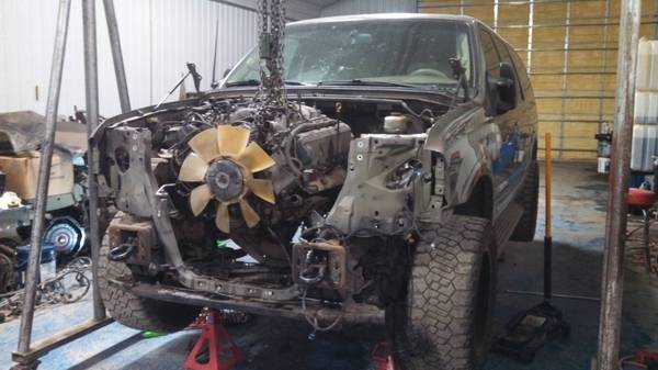

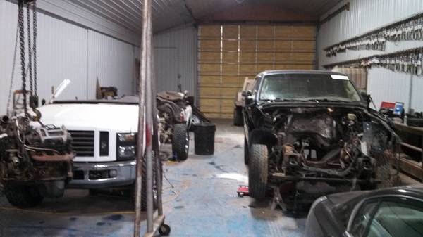

Well, I got the new donor to the shop, and I. Many ways it's better than I expected. After I peeled back all the broken junk, I put power to it, and it fired right up. It looks like I need most everything from the water pump forward, but luckily the pcm and abs module were untouched. Here's the extent of the damage with most of the broken stuff peeled back:

You're making progress Wayne, looks good! If you don't have all the stuff from the water pump forward, let me know and Ill hook you up.

Thanks Seth. Expect a call in the next few days. :D if it is missing from this pic, or a complete v-10, I probably need it. I will put a list together.

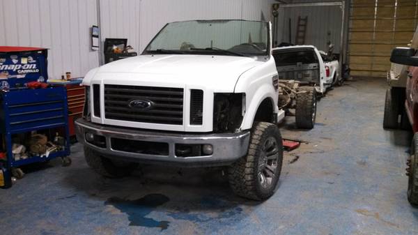

Well, both projects picked up the pace for the next month. I took a new job in another state that starts in 6 weeks, and in order to move, I need the 6.4 project as 1 vehicle, and the v-10 to 6.0 conversion complete to do that. Thanks to Seth, for a bunch of factory stuff, and my account at premier, things are well on their way.

Exhaust for the 6.0 just showed up. Apparently I bought the last of it's kind as a discontinued kit from MBRP. 3.5" down pipe to 4" aluminized "off-road" system with a muffler. Everybody seems to still make the kit which retains the cat, but I want to do one of those "high flow" cat modifications that slip over the pipe, and weld in place. I've also decided when the time comes I'll try for the 5" hypermax kit for the 6.4 excursion. It seems like the excursions are not nearly s well supported as the trucks unfortunately.
