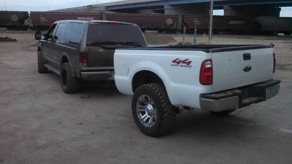

Since I'm changing jobs mid-project, and I don't have time to sell most of the good left over parts, I turned a bunch of those parts into a temporary trailer to haul a bunch of the other parts.
Yeah, I know it's pretty redneck, but emphasis on the temporary situation. Once I get everything to Twin Falls Idaho (hopefully done moving after this for a very long time), I'll stick it in storage until figure out all the details. The '08 frame section is obviously cut, and I've got the body clip ready to go on, so tomorrow will be the beginning of the frame graft.

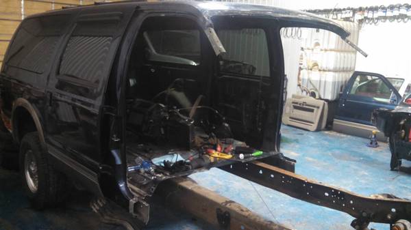

On that note, I did a lot more close inspection of the two front frame sections. Almost everything would be perfect except for the excursion main frame rail sections being about 2" shorter than the '08's, just in front of the front cab mounts, so I won't be doing the graft as I hoped. I will just do it under the cab like everybody else does, and sleeve it. I was really hoping to not need to cut anything but rivets and factory welds, but that's life, I guess. I'm not worried about strength, but I was hoping to go for an extra clean factory look. More pics to come in the next few days as the two halves come together.

Thanks. I just drilled out the spot welds to separate everything except for the inner rocker liner, which will be overlapped. The floor and rocker joints between the 6.4 and 6.0 are identical at least. The windshield posts are staggered 6+" from the insides to the outsides, but just at ideal locations. There are no joints to separate on the A pillars.

That's definitely the nicest truck bed trailer I have ever seen lol! 08+ bed with monster rims! Can't wait to see the ex done

Monster wheels are gone off the trailer now it's sporting the axle and tires from the blue ex. I have been doing some cutting, welding, and axle swapping though.

unfortunately I'm flying solo without a lift either. I'm too cheap to pay for help LOL I had to get creative to bring the two halves together where everything lines up, but all the gaps and body lines are perfect, so I'm good with that.

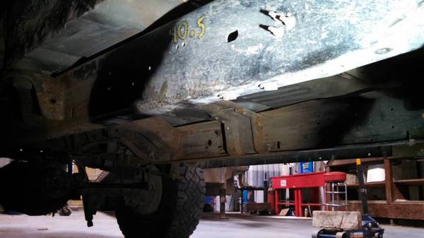

Thanks guys. I finally got a snap shot of my unfinished frame graft. It still needs the inside plates and some clean up, but without a way to lift the body at the moment, and finishing my move from North Dakota tomorrow it will have to wait until I get set up in Idaho to be finished. If all goes well, I will blast and paint the whole frame anyway, but here's a pic to at least show the graft location.
