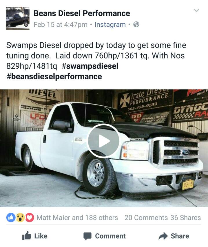

760 rwhp on fuel today. Not too shabby for 3/2s and Forced Induction 69mm that kicks ass. 😉

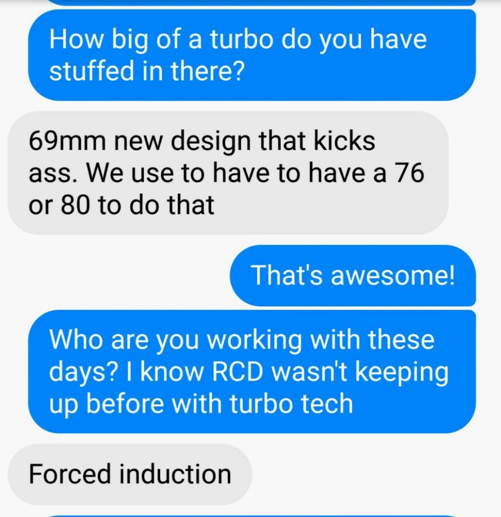

That was 760HP/1361 TQ on an sxe369 and 300/200?
760 on fuel, 829 with nitrous.
I saw the video on Facebook and just asked a couple questions since I knew he was on his way out of town to ride RZRs... I honestly just wanted to know the general setup since I don't keep up with all the builds these days.
300/200s, ported heads and deshrouded valves. Two small jets with a cold bottle for the nitrous run. As far as the turbo.... It definitely kicks ass, but we didn't get into specifics.
