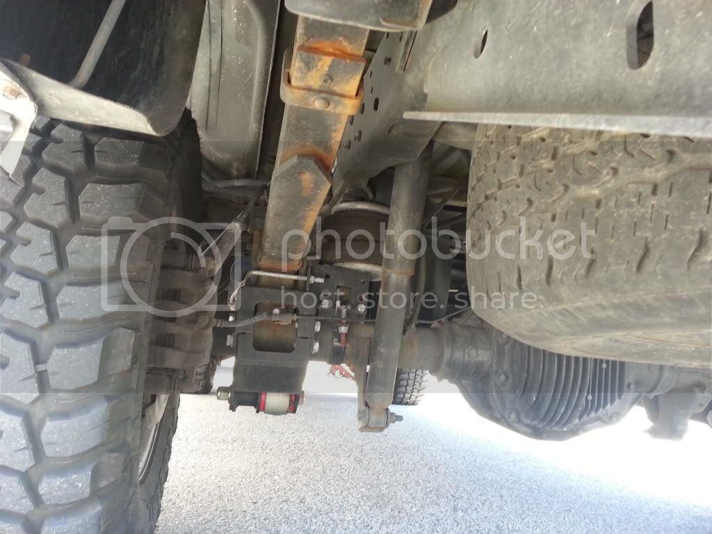

I have the FireStone bags and the Airlift onboard Air with the gauge mounted under the flip cup-holders. No issues after 4 years.
My only gripe is the way they sit on the axle. they have an arch that depends on the weight/pressure to keep them on the axle. I've caught them hung up on the blocks a few times.

?? Im pretty sure there's supposed to be bolts in top and bottom, or a clip on the bottom...are you sure these were installed correctly? (Im not saying you messed up but Im concerned their not on properly)

Im sure there was a bracket and the Douche nozzle who swapped my traction bars to the PMFs lost them.

thats not even CLOSE to right! Dear lord... I suggest making a bracket off of your spacer block (weld or bolt) to keep that sucker in place, Its putting improper load on your axle tube..NOT GOOD MAN.

This is my set-up inside frame rail firestone with on board compressor. Pmf stage 2 traction bars.

HA! Awesome. I had a feeling it got ****ed up somewhere. Never payed attention to it until last month. My axle is pretty mangled as it is. Had a set of fabtechs welded to the axle rip off once before.
Meh, i'll just order a new Bracket kit or something. I have that ghetto squat for a bit next time i really tow
