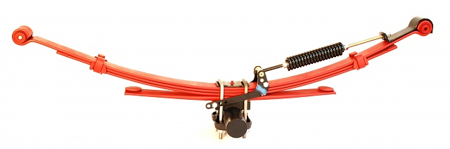

I am thinking if it wasn't a gimmick We would see them implemented by other MFG's
but it's just this one company and 400 bucks ?
If I can only get all the mfg venders to give me a set of their products that they want me to sell. I can install on my truck to see how well they work. How can I sell something I can't sample.
