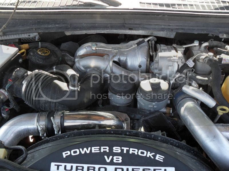

Of course started out nice cool from sitting overnight....nice before shot

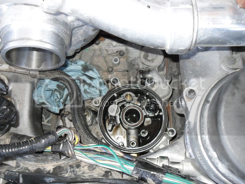

Started out by removing the oil housing, gotta remove the turbo oil feed lines and then 4 torx bolts are the only thing holding it in place, bottom bolt is a pain so just take your time and then the oil filter support stand is easy removed with one bolt and twist of the stand, when you are done, it should look like this.....
You don't have to but I removed the intake tube to access everything better

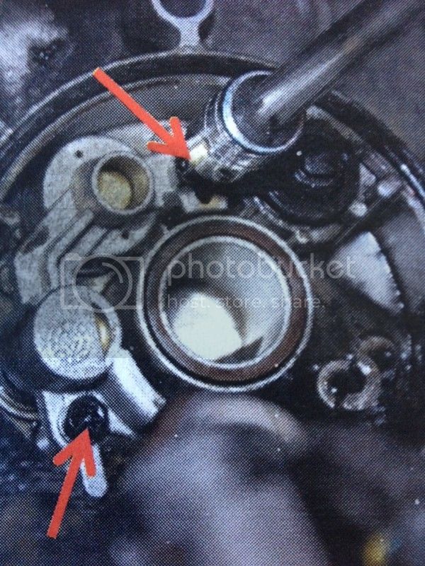

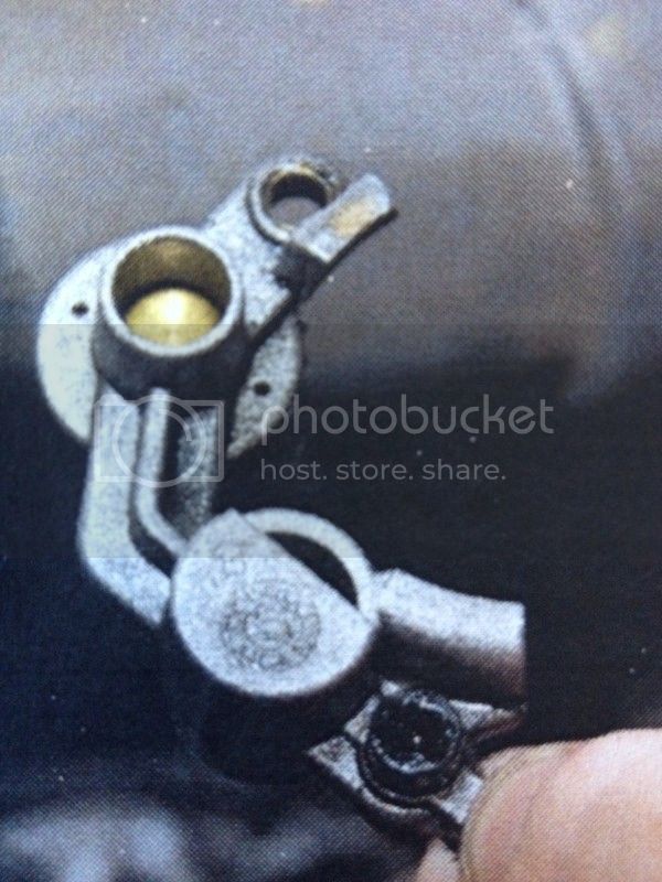

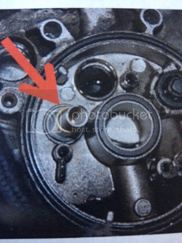

Next you are going to carefully remove the stock bypass/anti-drain assembly by removing the two torq bolts holding it in place....
When it comes out, it should look like this....

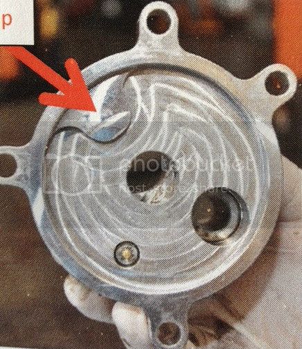

Look back in the motor, you should replace this spring with the one provided....

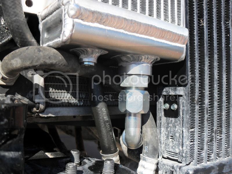

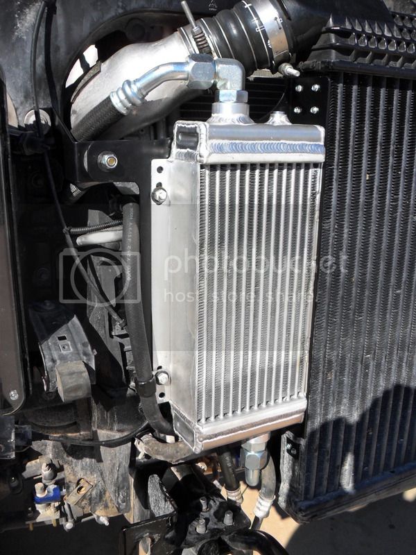

After the oil cooler gets mounted to the intercooler with the bracket provided, the 51"/oil in hose goes to the top of the cooler like so....

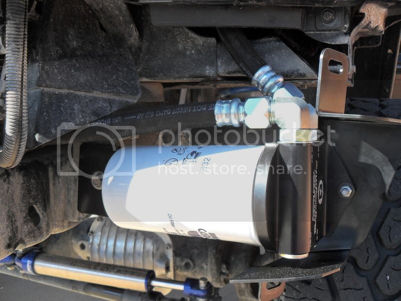

After removing the front bumper, you attach the oil filter mount to holes already in the frame, at this time you connect the 54"/oil out hose to the 45 degree "oil in" port
Then take the 46" hose and connect it to the "oil out" port and run it along the bottom of the core support to the bottom side of the oil cooler, like this....
