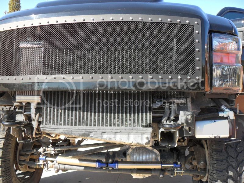

Button everything up, start check for leaks, and then add oil as needed......took an extra gallon for me and it should look something like this

Nice write up! The parts looks very well built also... but what is the servicability like when the front bumper is on? That filter looks like it would be a major PITA to replace. Also, I wonder how that filter/mount would work with aftermarket front bumpers? Do you have some close ups, or other angles of the line that goes to the top of the cooler that runs near the CAC pipe? Also I'm wondering how an aftermarket CAC pipe would affect anything... if it would at all?

Not sure yet, as the "rhino lining" on my bumper started peeling and I just left it off and dropped it off this morning to get fixed, but you are right, it might be a PITA to change the filter, we'll find out soon. I can get some more close ups of the line running by the CAC, what are you wanting to see exactly??? As long as the aftermarket CAC pipe isn't bigger in overall diameter I don't see an issue

My only concern with the CAC pipe, was in my case for example, i'm running the No Limit setup which means I've got the 3" pipe running through there and room is tight. I'm just looking to see if the new oil line runs below, or above the pipe and if that extra few inches us with larger CAC pipes might need to pass through the radiator support might be the difference between no fitting and fitting? I love this kit, but just wouldnt want to purchase it, then have issues fitting everything due to some other aftermarket parts ya know?

Looks pretty straight forward, the oil filter could be a PIA. Wonder about moving or angling it differently, but that would probably require longer hoses with different elbows.

or you could use their hose, and just get a coupler, and make theirs longer by adding your own, if need be.

Kit is working great, had to re-route one of the hoses and the filter can be changed with little mess.....I'll get some pics later today, but this was today, running down the highway with it being 69* outside....194 where the coolant and 175 was the oil
