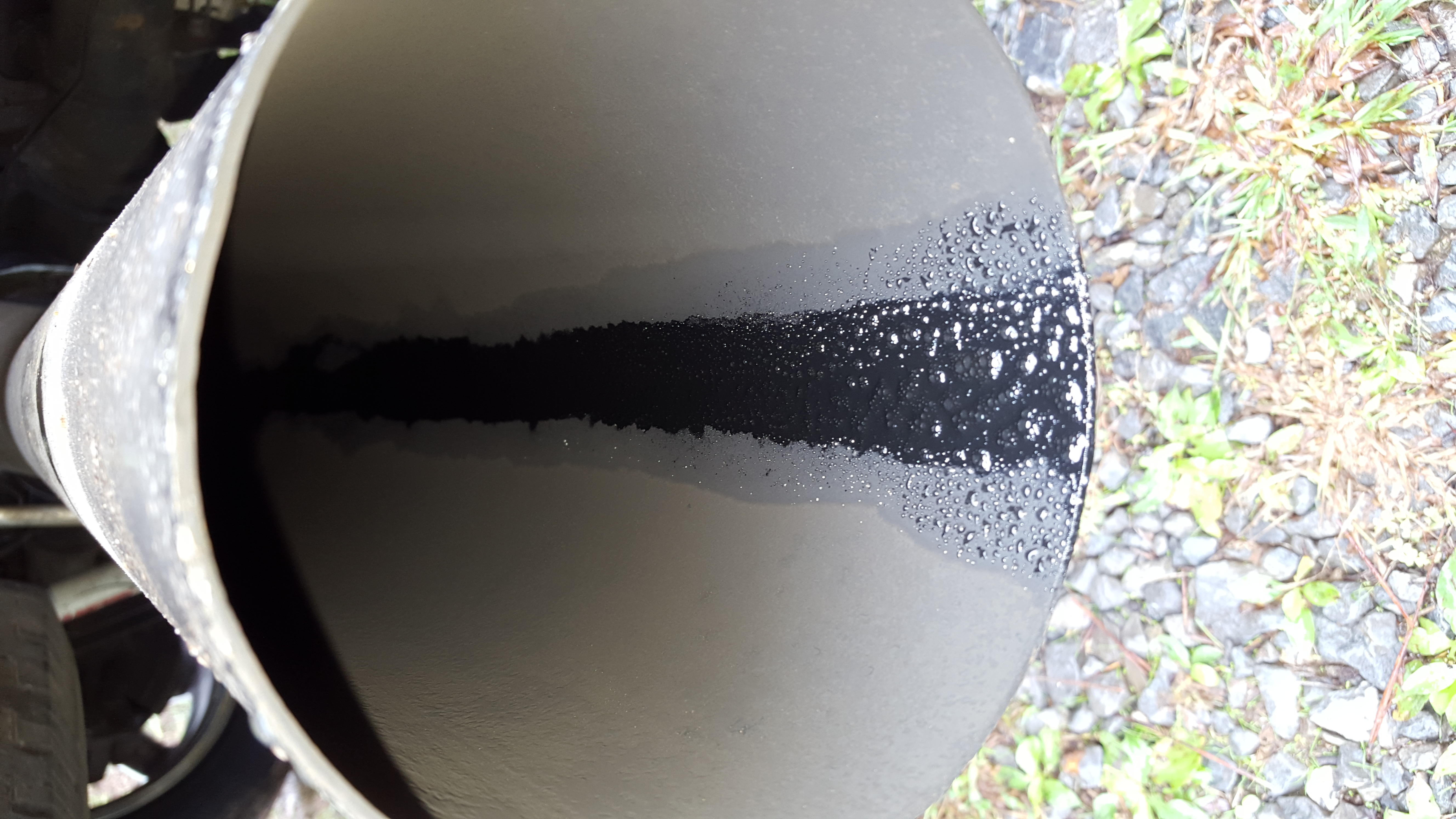

Found the failure. Lol.
TALLBOY
May 31, 2014
62
their ya go. i guess bad seal instead of the bearing?
Well know way of really knowing that. Could a been a bearning that went out that caused the seal to go from movement. But I do recall the turbo smelling like it was burning the entire time it was on the truck. Just not sure the exact cause. However I do think it was just a bad turbo. My new one from Barder is on point so far im liking it way better than the first. Even sounds like a different turbo.
