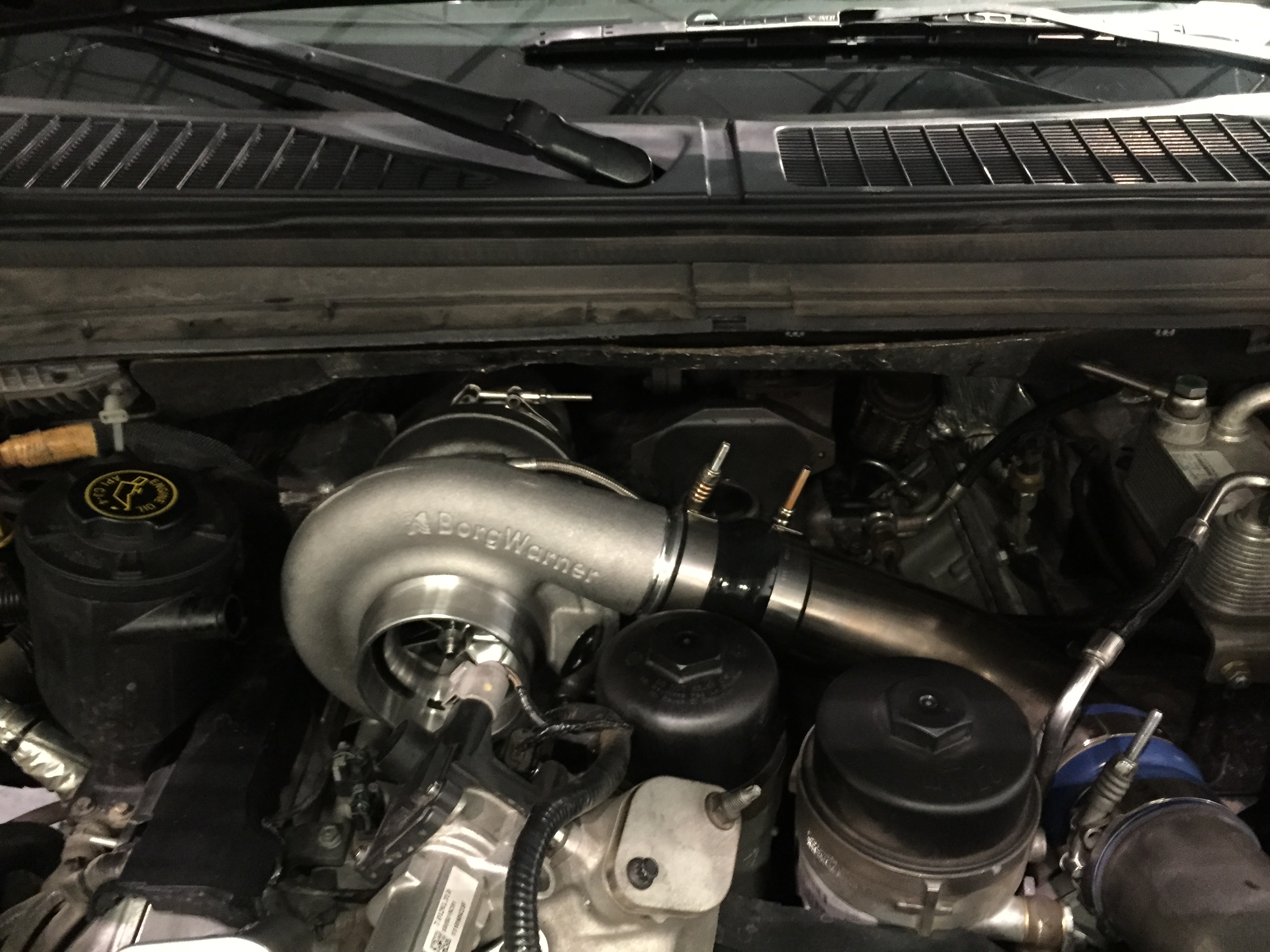

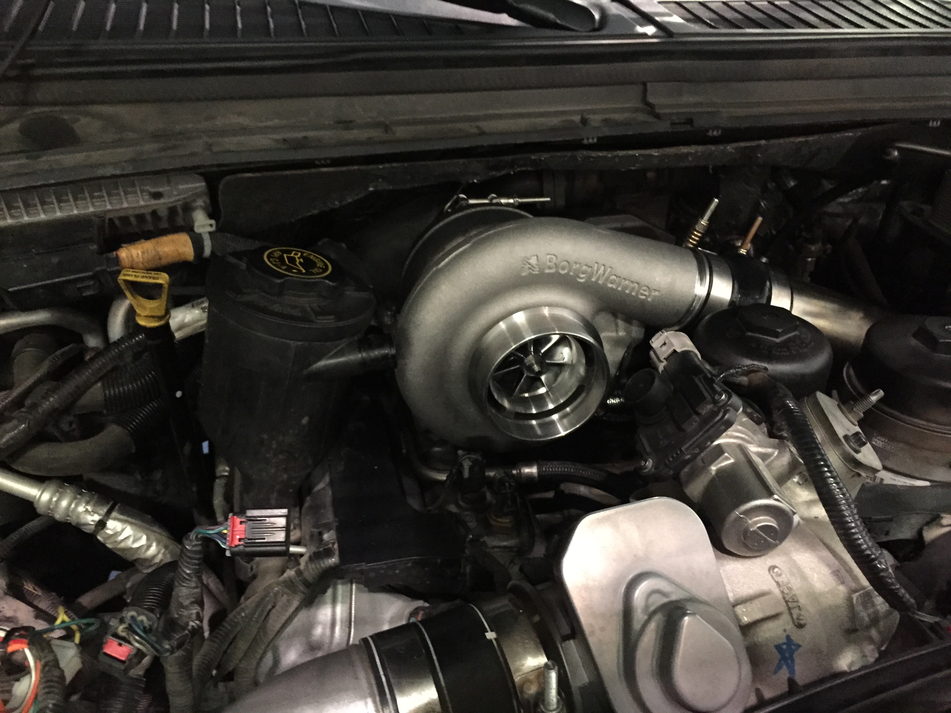

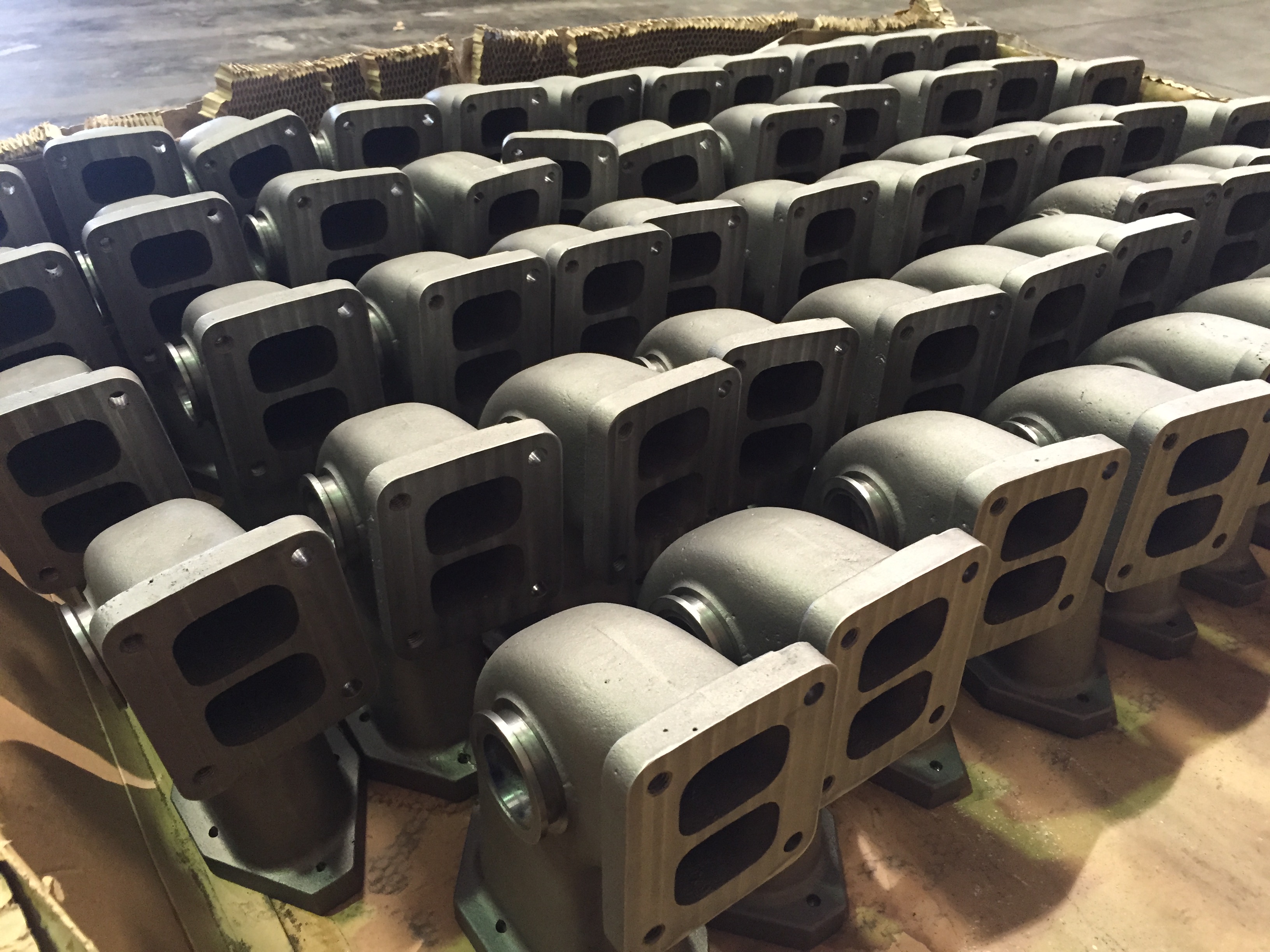

Dyno'd ours last week with the 69mm on it, made a solid 60hp over the 64mm. Our dyno seems to be consistently 100hp lower then everyone else in the country comparing trucks with very similar set ups. That being said the number was 678hp with the 69mm. The 69mm is very drive able, but is still a little slow for my liking compared to our custom billet 64mm. We put the SX-E 66mm on it yesterday, drives much better at lower rpm vs the 69mm. Dyno results say the 66mm makes more torque, but is 15hp less than the 69mm. All that being said I will take better drive ability any day over 15hp on the top end, but that is just me.............We should have all the SX-E turbo options with our complete bolt on kit ready here in a few weeks.

Everything is in stock now except the down pipes........ They ship tomorrow:)
So if I have your current kit what do I need to purchase to put on a t4 twin scroll like the 369 . The pedestal and the down pipe? Anything else?
Jan 19, 2015
752
John, you've got the 6.7 kit correct? Zane is referring to the 6.4 kit when he says downpipes will be here shortly.
The 6.7 kits are right behind though.
