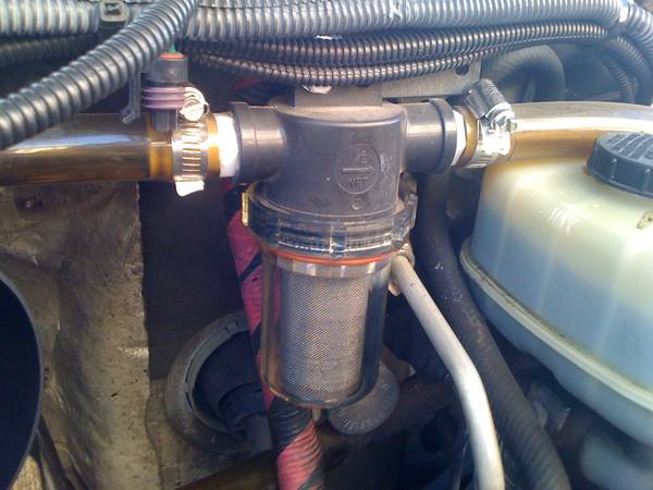

There's no backpressure with the strainer routed back into the stock location to the intake. With the engine running I can pull the hose off the inlet of the strainer and stick my hand there and feel a vacuum.
Plus the oil that collects at the bottom of the canister shows me it's trapping most of the oil too.
Here's a picture I took of it a while back when I had stuff apart:
Managed to mount it under the hood right behind the intake tube. The hose runs around and back under to the stock CCV inlet in the intake. Easy to see and it's right there to empty out when I change the oil.
How do the inside of the CAC tubes look with that?
I had my tubes apart a while back for something else and was really amazed how oily they were with the stock CCV.
I still get a little bit of oil. It's not bad. The t-strainer catches most of it. At some point I may add some scrubber brushes inside the trap to see if that will hold more of the oil. But for now it works just fine.
