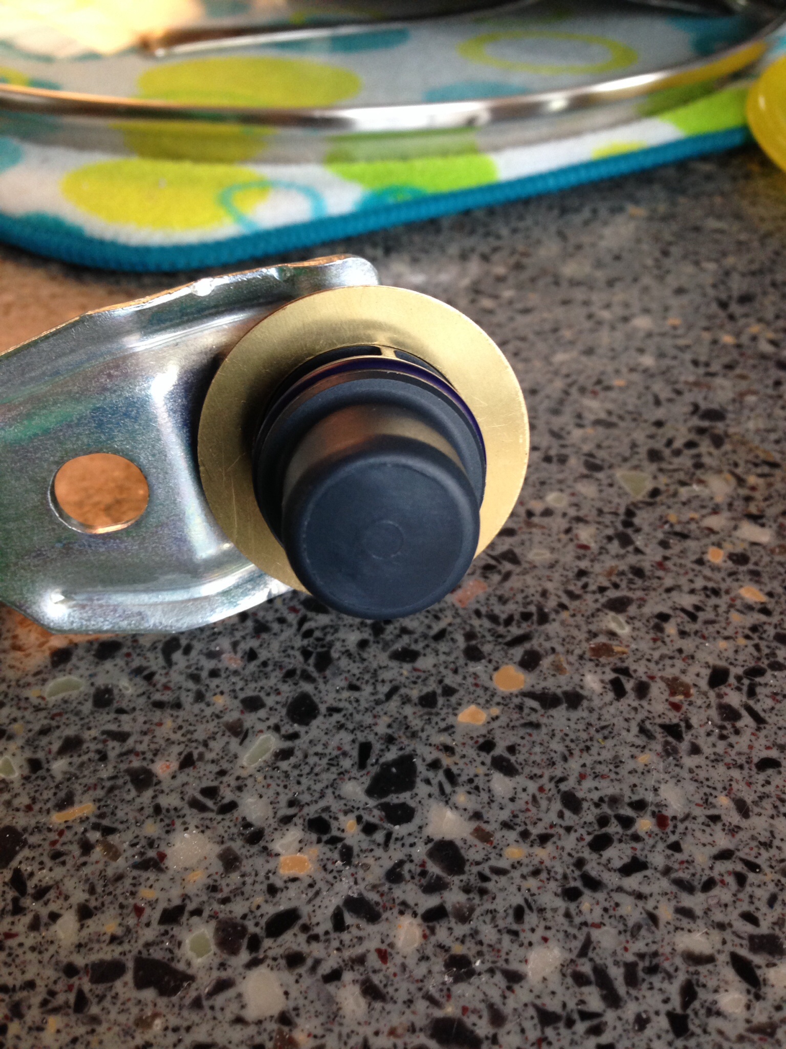

rusty1161
Jun 21, 2011
876
Whittier, CA
rusty1161
Jun 21, 2011
876
Whittier, CA
Here are a couple of pics of the shims in that Ebay kit.
Rusty
