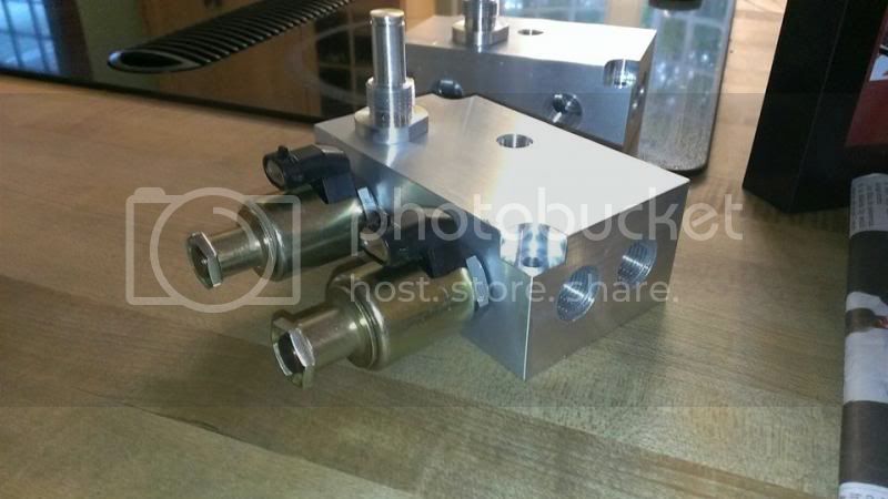

Will do Tim. I'll be running stealth dual pumps so I'm going to run a line from each pump to both heads. That ought to balance just fine instead of running a balance line between the two pumps.

That looks familiar.

I popped one of the freeze plugs on the back of the block when the HG let go....so I don't have enough miles on it yet to say definitively. Idle quality is subjective...that seems better so far. The way it's setup....I'll be able to just remove 2 lines and cap off 4 plugs...and do a real real back to back comparison easily. Same on the balance line. I'll definitely share what's discovered.
