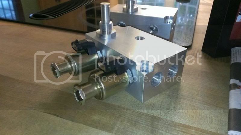

I will be getting the local hydraulic shop to make me lines for my ipr's. Just rubber lines like you would see on any piece of equipment. I plan on mounting it on top of the ac compressor. Never thought of doing hard lines tho.
Is tha BTS set up?

Has any one done a 4 hose out on the BTS dual pump setup?
Both my pumps are out now for the serviceable plug and I
have had two pumps in the last two years puke the rear plate.
