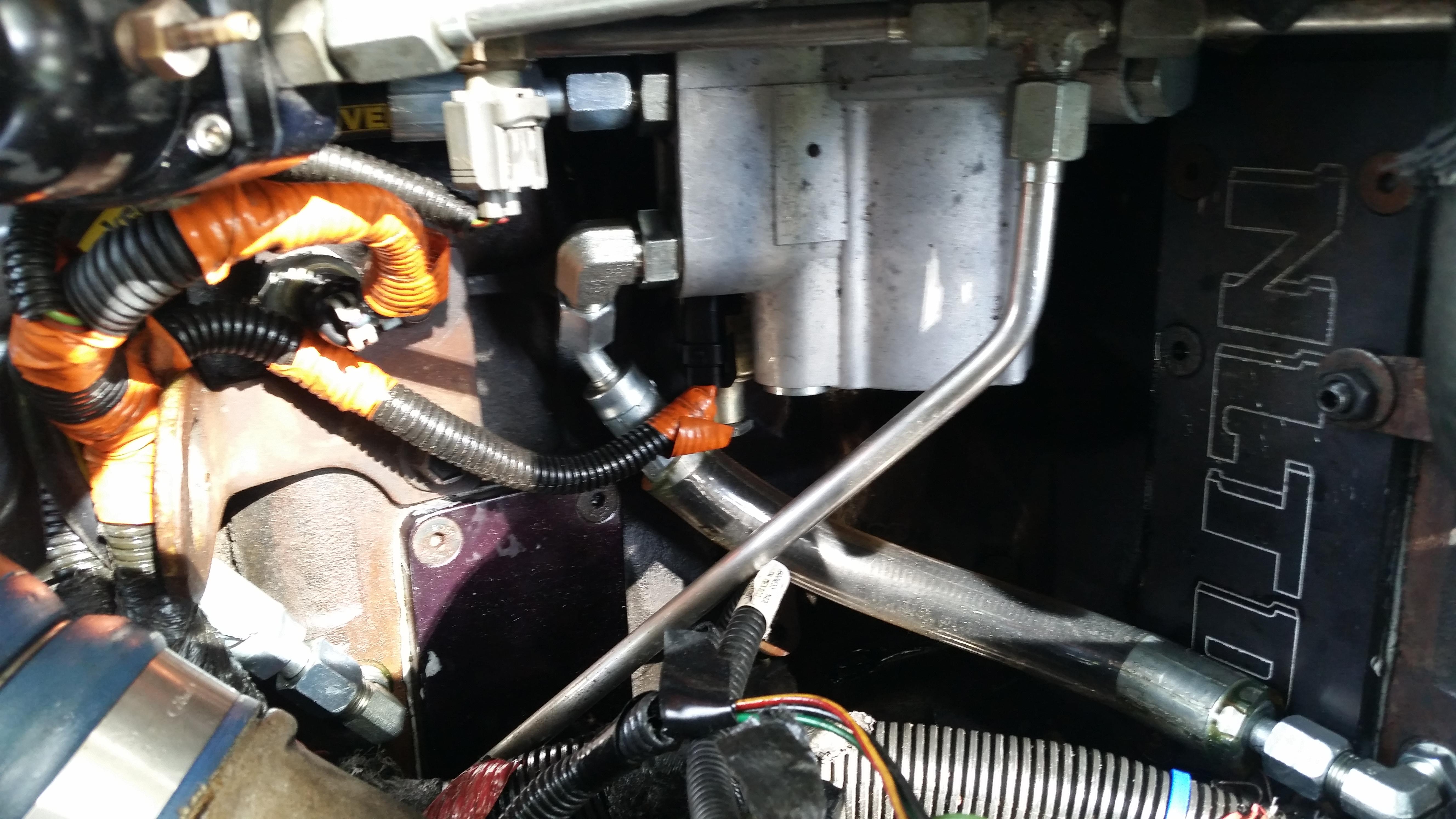

Here?

Nothing, joey, I just don't like stc fittings.
Mandkole, I have not heard of delamination issues, but when you talk about internal hose failures, I just picture little pieces of rubber flowing thru my oil system, lol.
I'm no hose expert, so thats probably not an entirely accurate scenario.
However, I have seen embrittlement in some hose covers. That's not uncommon, even in lower temp applications.
