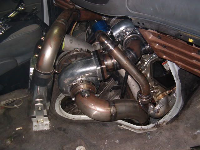

click the picture my compound setup is there. lots of pics. went through the piping a few times. (3) i think it came out well.

looks good kyle.Have you dynoed it?
no not yet. still trying to finish it yet. lots of work in the shop,and lots of pipe issues under my own hood,has severly slowed this build down. but the piping is pretty much done now. things should move alot faster now.
