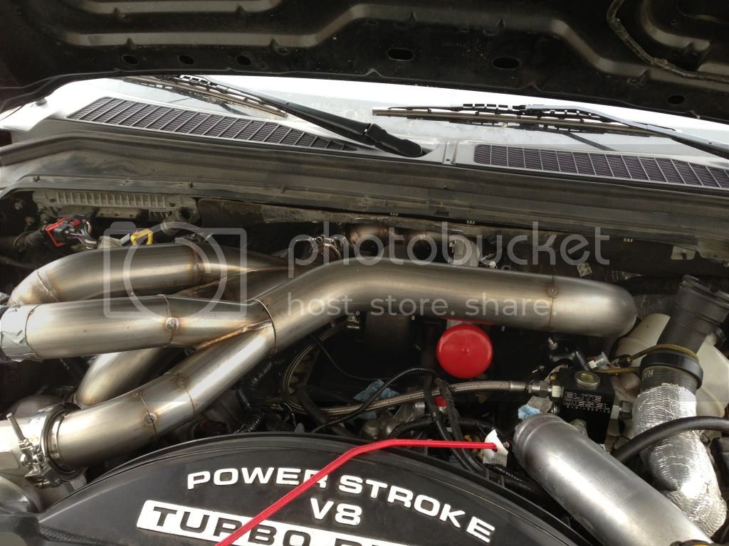

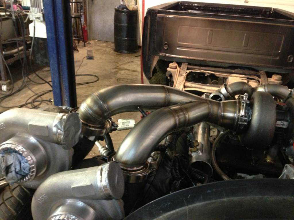

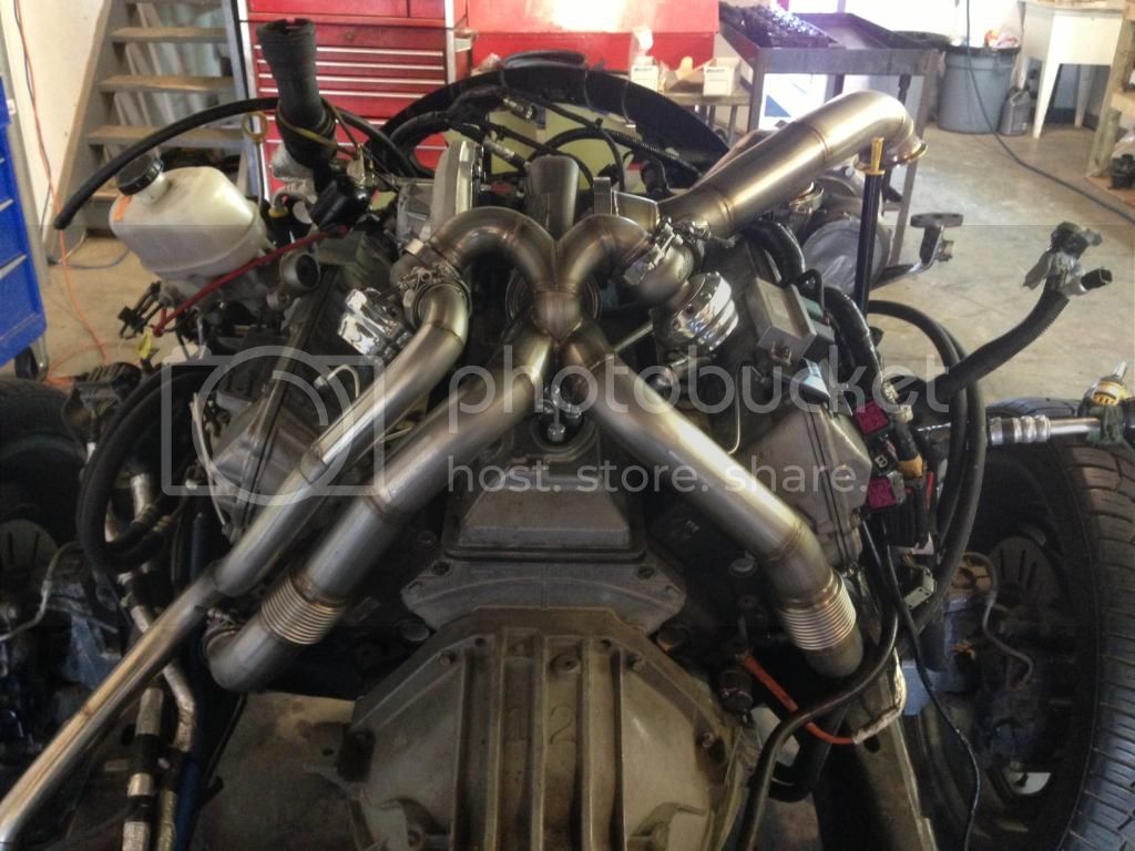

One wastegate dumping to intermediary and one to atmo?
Is that for when running nitrous?
Yes to the first, no to the second.
I am running two gates because I like the ability to control/modify my stages if I choose to...

As always, looks fantastic!

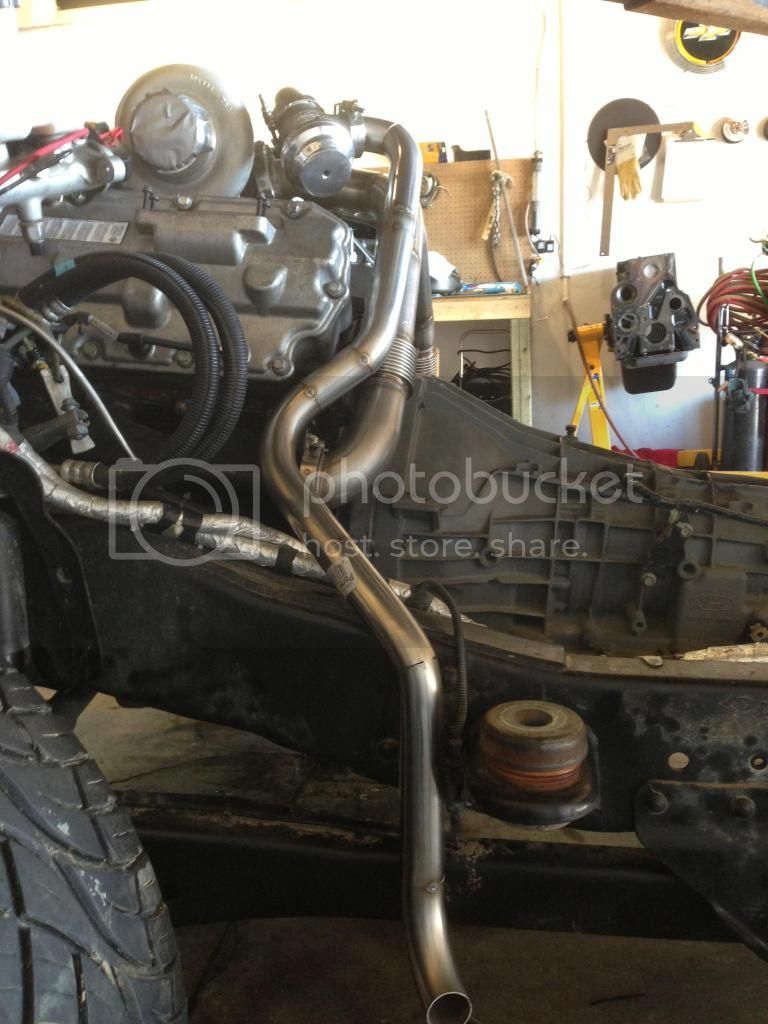

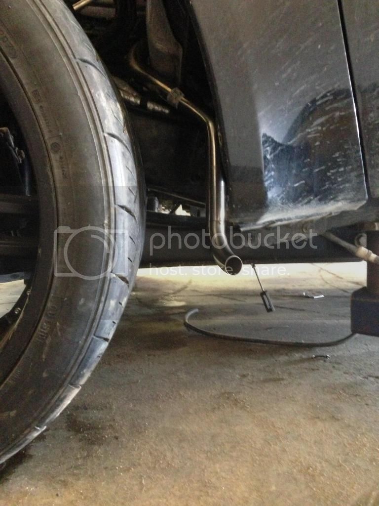

Any ideas on the downpipe?
3.5 or 4" out of each turbo then merge fairly quickly to 5" and under the cab to the stack.
I was going to remove the stack and go back to a side rear exit... But I want to listen to that stack lol.
