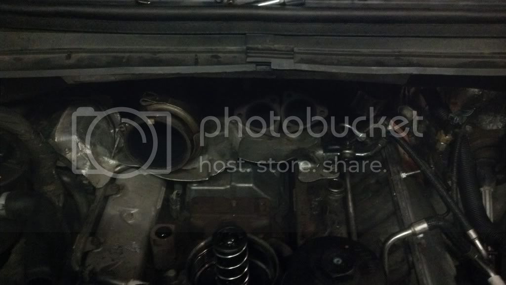

I may go pick up a flex head later today. I know you guys are here to help and I am very thankful of that. I'm alittle worried I may have hurt the vgt turbo. When getting the actuator fork out everything seemed fine then the ring for the vanes locked up and the compressor wheel will no longer spin. The guy the fork attached to moved too far back and I can't get it back forward. I'm kinda burnt out on it, been at the same stage for like 8 hours with no improvement. Giving myself some more time. Trying to enjoy my birthday somewhat at the moment.

The vgt ring dropped so don't spin the comp wheel or damage will occur. You'll get it. Patience though. Oh and go enjoy your birthday bud. Have fun and then come back to this, if it makes you feel any better I spent 4hrs putting bolts back in a machine at work, all 4 of them.

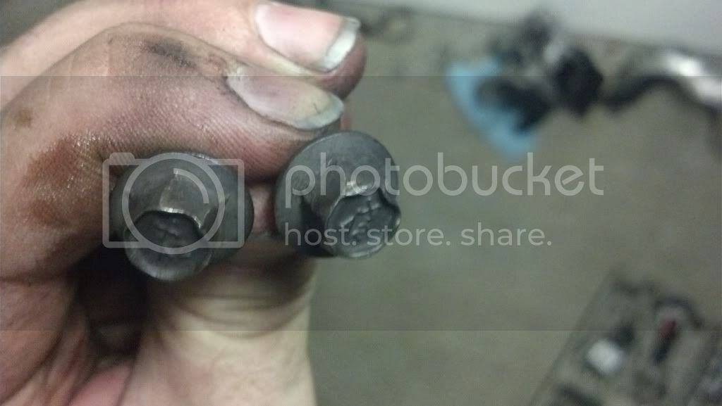

Boom!
Stupid bolts....
Thanks to I believe white monster and dustin for suggestion the 3/8" flex drive, broke both loose of the first shot, when threw a whole can of penetrating oil in that last few days, and thanks to everyone else.

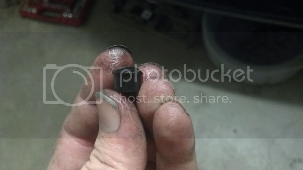

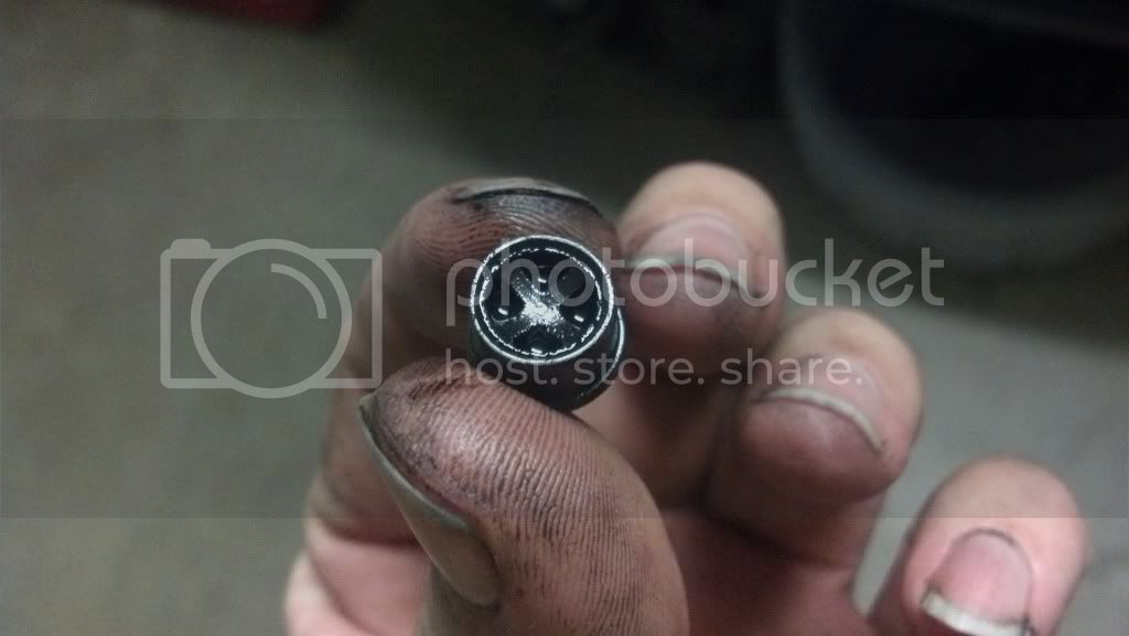

Anyone know what this is? Its was in the bottom of my oil filter housing. And does anyone have the part # for the stand pipe the oil filter goes down over? That little piece looks like the piece in the to center of that.

Yes that is the peice off the top of the oil stand pipe.
The part # is 3c3z6c755aa

:shrug:Not sure what to tell you about that then. Maybe that part broke a few times for some reason, and now is fixed and the person fixing didnt look for it. Mine was broke at my last oil change somehow, and it costed me $50 for the new parts.
