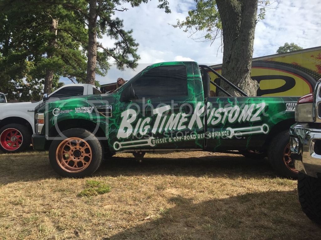

You're welcome to run mine at Rudy's if you get yours to fit a 16. But sounds good!
I appreciate it. 16s wont work on this one and don't wanna get into grinding calipers. I have the hoosier tires pretty much ready to be dropped off at the shop, just having a hard time deciding on the wheels to run on them. Since the copper ones on it now will be very hard to beat.

You looking at 18" wheels with 325/45 Hoosiers?
I'm having a hell of a time figuring out a tire/wheel setup myself.
The tires are perfect, but can't find wheels I want in 18x10. Might just have to suck it up and run the same mavericks everyone else does...

yea were going to go with an 18, just not sure what yet. the idea was keep the 420s and copper kranks for shows and dyno events, and just get the lightest wheel possible for the hoosiers for the track. but with everything else still left on the truck, I let the 2nd set of wheels slip past and figured il just use this set up till next season.

Nothing wrong with 420's, you can cut low 1.6's with them, just have to be careful on the launch.
I'm running a/t's right now and 4x4 burnouts on a prepped track slinging rubber and vht all over my truck is getting old.

yea the hoosiers well get it hooked no doubt better, we were hoping to have more time with it this season, but with all the issues with hit with the truck were happy to make a few passes this year, and get it dialed in for next year as well as make sure we have a motor that's up to what we are planning for it.

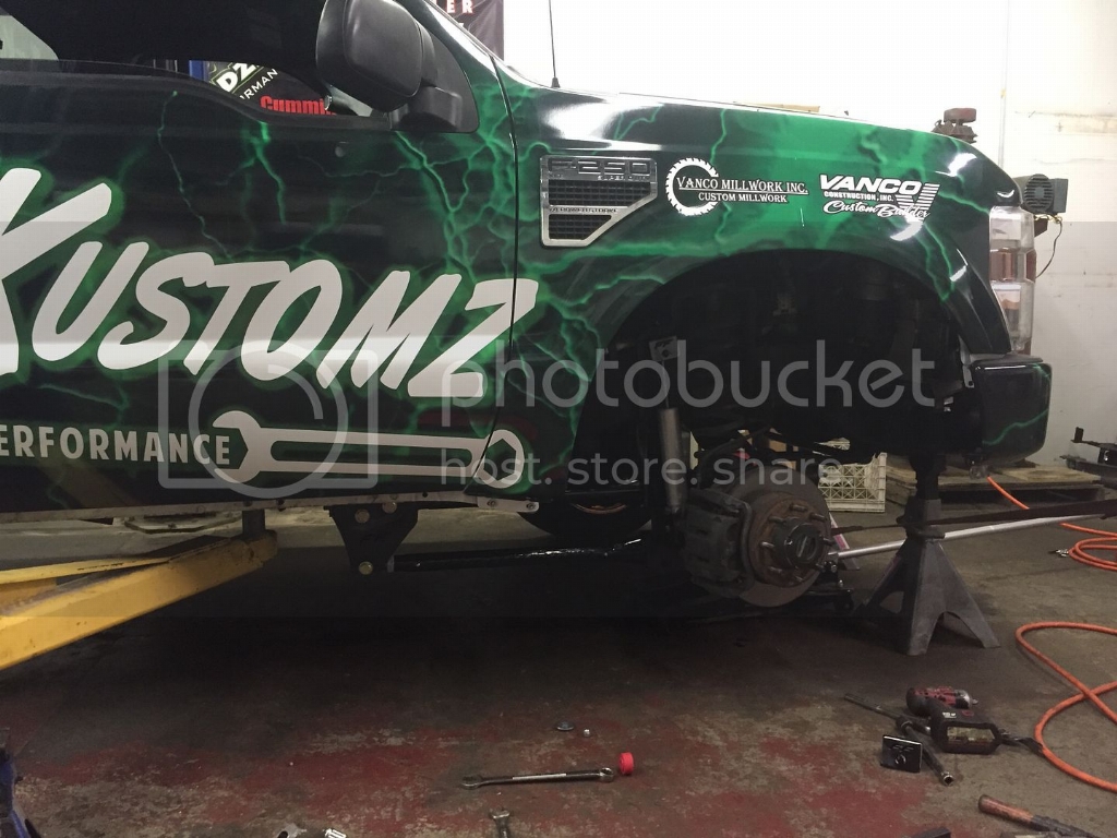

well last night we got the 4 link on from Flight Fab, as well as some adjustable Rancho shocks and limiting straps.
Eric got us some tunes for the truck which we put in. all that's left now is nitrous which im on the fence about putting in for this weekend. were at about 200 miles on the truck, really want to see some more miles before I start spraying but well see what peer pressure does.
trucks running good, so were excited to see what kind of fuel numbers we get at the track tomorrow.

im not worried about breaking, im extremely confident in the motor we put together, I gave the red truck 1000 (Almost) miles to break in and have the rings seat properly, as much as im ready and waiting to push this truck hard, its worth the little extra wait time to make sure everything is broken in properly that way when we push it, we know it will take it and be fine.
