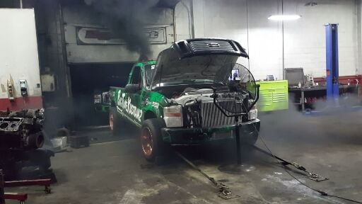

mini maxx should max out at just over 70 ebp
I would think boost would be around what your back pressure is reading. In the 65-75 range
ideally yet, but this isn't always the case
Wow. Hope nobody's standing near that thing.
atleast not without a helmet
this is why craig thinks we should change the housing size also thinks the smaller housing is choking the turbo out...so well see
I didn't have my helmet that day. None of us did. We're still good.
100psi out of a single turbo ?
The boost sensor is on the charge pipe about 6 inches from the v-band, so that is a pre-intercooler reading. post should be lower. Have to remember, small turbine and tight housing, it is getting pushed way harder than a bigger setup.
that turbo will be trashed in short order.
have a 1.0 housing in the works
when james originally put this turbo together thinking .90 and a gate for compounds but since its gona stay a single for a little while were gona go to a 1.0 then well drop back to the .90 and gate around it for compounds like we originally planned.
Why not just open the gate??
