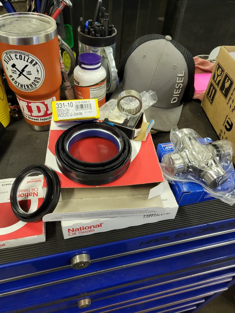

Lifted it and spun all the wheels and can't hear anything. Removed right side front axle and the spindle bearing is definitely toast. It had a ton of slop in it. Got a new seal ready to go on and I'm shoving it back together.. I would shocked if this was it. Front diff looked and feels great
