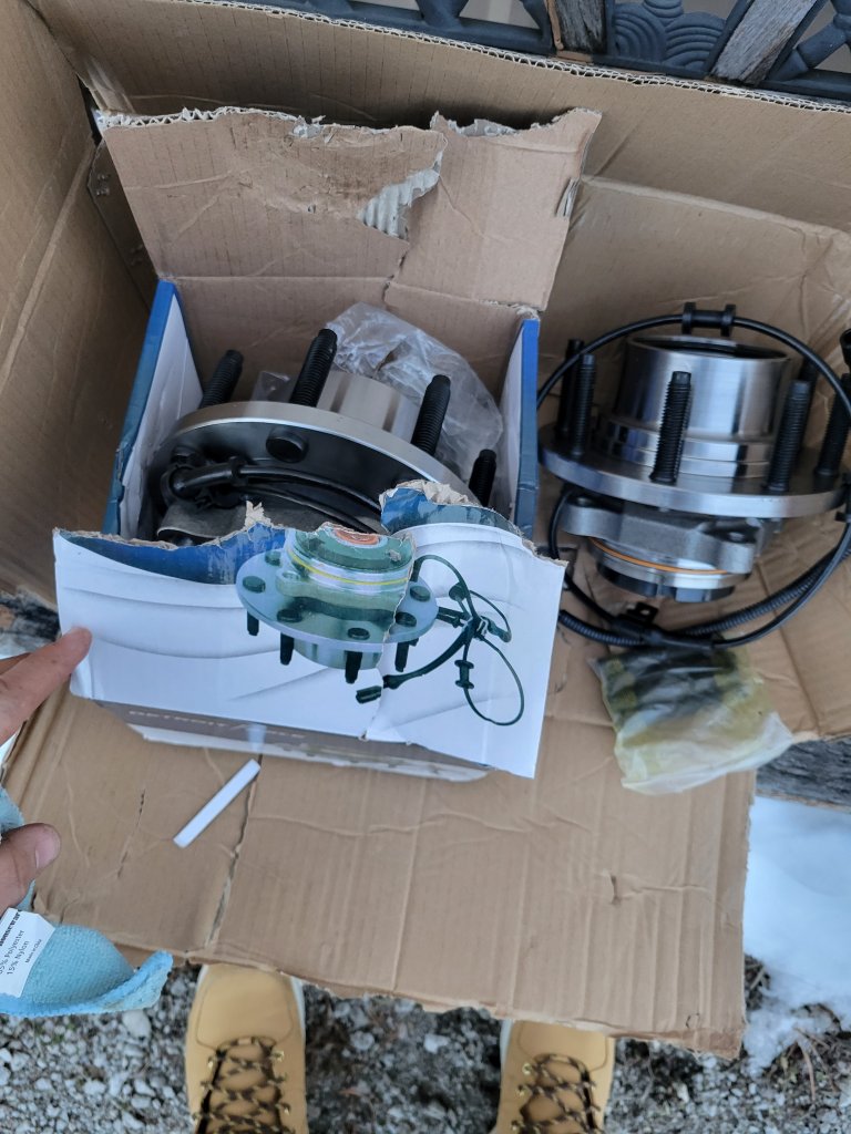

I got these hubs in the mail today and the box was absolutely destroyed. One even smashed the connector so 2 more are coming. Lmao.
This is going to be good.
I too feel your pain. Ordered a rear hub for a sterling and when it showed up the box wasn't that bad but it was definately bent, so I was guessing someone reboxed this bent hub.
It probably wasn't it's first trip through the mail.

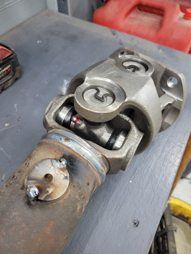

Double cardon is my issue. You legit have to find the absolute perfect spot with the truck in the air to figure this one out.. I've spun this shaft a dozen times. But it's ****ered
Look at post 2 you jerk... Kidding of course! Man I hope that's it. Much better you find it sitting still than at 70 like I did.
Yup. The driveshaft was shortened, balanced, and new cardon a year or 2 ago and have used 4x4 maybe dozen times.

I had an issue where the inner slip shaft was hitting the back of the front u joint cause the shaft was too long. Which doesn't make sense cause the truck is lifted. So had it shortened

When I rebuilt one, I didn't think the ball was serviceable. The socket was in the replaced center piece.
Do you know the history of the truck? Could the shaft have been for a Dana 50 front axle, and you have a 60? I believe they are different lengths from axle center to u-joint, 60 being larger.

Oh yeah. The ball is loose! From what I remember that should be secure to the longer portion of the shaft. That's a definite issue.
Not sure what whoever rebuilt it would say about that. I wonder if they just let it ride? Or if it isn't serviceable so a new shaft was necessary? Dunno but that needs help.
I've wondered a few times, would a CV joint there be a better smoother solution? Obviously GM thinks they are strong enough...

They sell ball seat kits, I believe the spicer number is 10018440. I opted get a new yoke with the ball in it (this was on a 97, but I assume it's similar), not the whole double cardan assembly, just the portion of the yoke that has the centering ball. This fixed me up.
