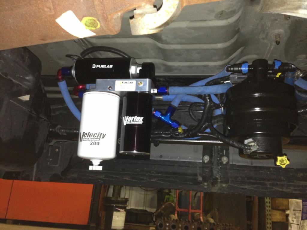

Pics of the fuelab setup on a 6.7.

What year truck is that? I assume 2011-2013? We are still in the R&D stage for the Powerstroke- especially the newer ones. However, I thought the 24v 6.7 wanted to see 53psi-73psi. If that's the case, how are you getting that kind of pressure out of that setup?
It's a 6.7 powerstroke. And they need 120-150 psi. So that's why I'm using it as a pusher for the factory LPFP.
That makes a lot more sense. I just read another thread of yours stating that. When I read this thread, I thought you were using this as a standalone pump for the entire truck. I had no idea how you were getting that kind of pressure out of that truck. Hahahaha

Holy s***! Thats a lot of pressure for the low side. I didnt know the 6.7 required that much to feed the cp 4.2. Nice job by the way Morgan, looks tits!

According to H&S, the LPFP on their 6.7 has only seen a max of ~75 PSI. Anything less than 50 PSI and it will trigger a low fuel pressure sensor and reduce power. Nonetheless, using a setup like this as a pusher for the stocker should work well :D

Yep it's on the website, lists for $1075. Has all the generic lines and fitting to hook it up. May need additional parts to hook it to whatever bowl delete/ fuel system depending on what you have.
