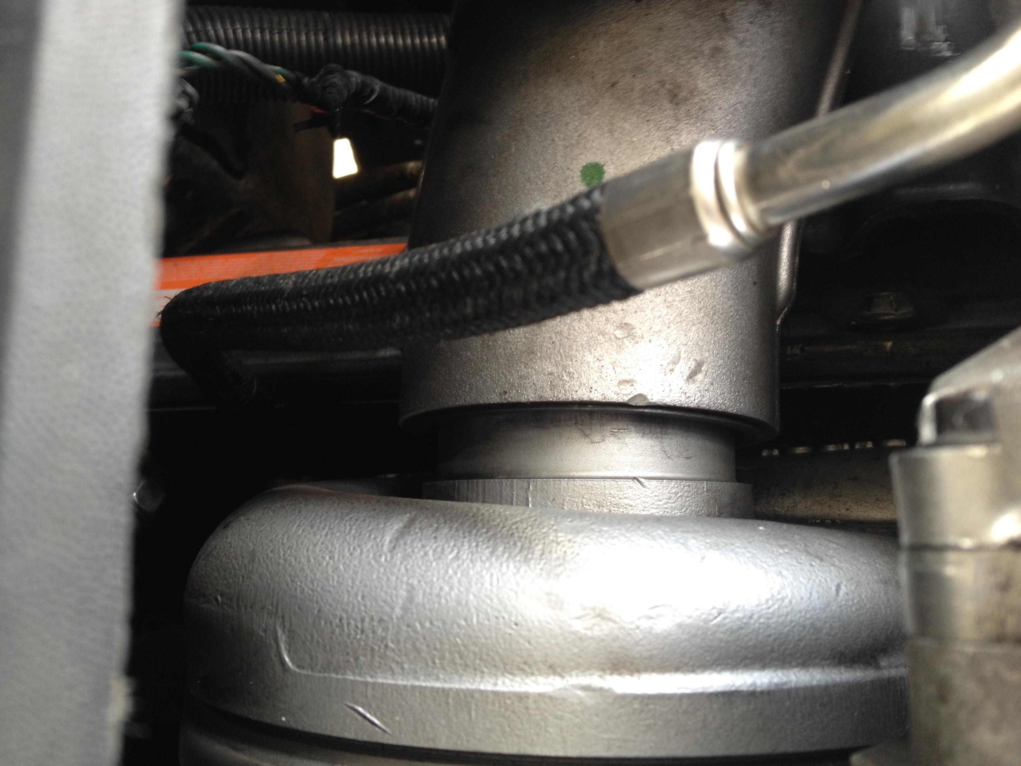

Also, it doesn't slip all the way on the HP turbo, there will be a gap. I can get you a picture for reference if needed.
How bout that picture? I think this is where the boost is blowing out @ after its starts builing into the high teens low 20"s. I have some oil residue on the high pressure turbo. I just can not get it to slide on on there anymore & do not know why. I'm so sick of this truck!!
U to high pressure

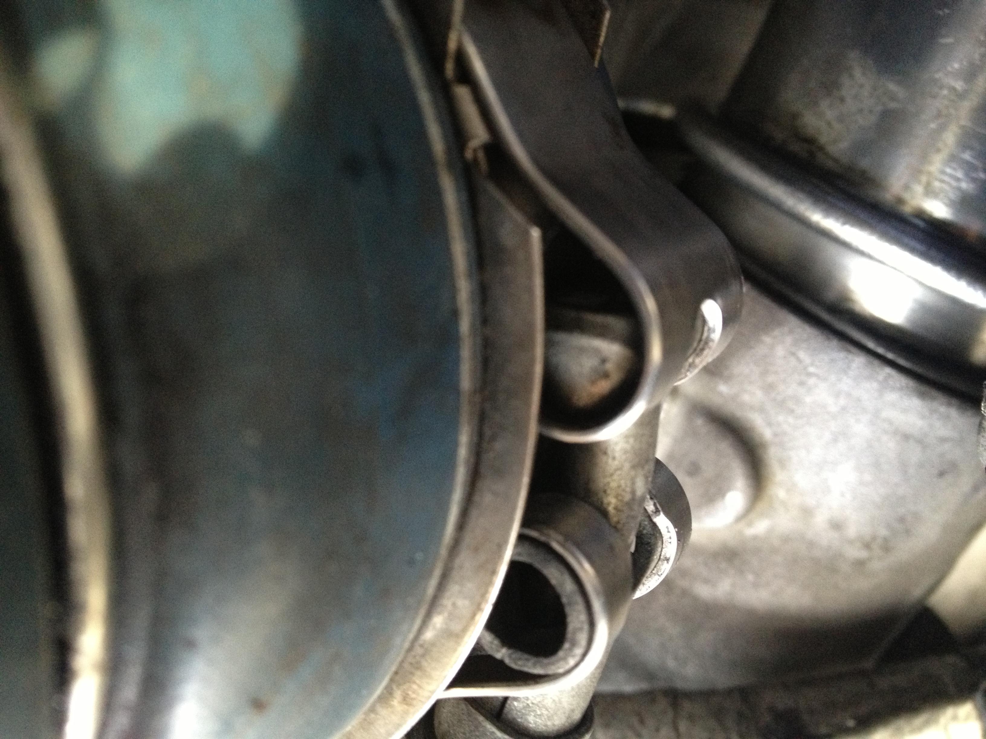

boost tube to U

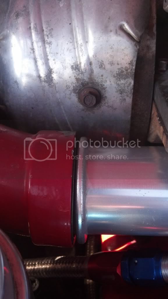

Bracket arm that bolts to valve cover, thats bottomed out
I think the turbo needs to come down a hair or over but i have no idea how to make that happen.
