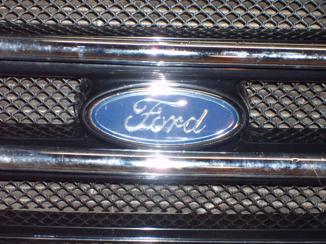

I have the mesh behind my grill but I think it has a little bigger diamonds in it.I ran the 203 stat and the temps stayed around 205 and my oil would be around 210-220..the same as our T444E rollback...I also noticed when I pulled my oil cooler that there was some silicone in the center section..I bought a used one from Marty and it was the same way..I did get them cleaned out but the truck is not quite running yet to see if there is a difference..
