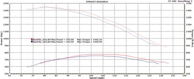

Just like the thread title reads. I have been discussing this with Mike H. and Dustin and we feel that there is a definitely correlation between turbo failure and air filter restriction.
When the filter is too much restriction the turbo pressure ratio changes as well as turbo speed. Too much speed equals failure.
On Erik Clausen's truck it was pulling the filter minder on every dyno pull. So we knew there was a restriction. We have yet to put a vacuum gauge to test how much but as a simple test Mike did a dyno pull with the filter on and then with it removed.
Wow! Look at the power gain without the filter at some points its 30hp and 50 ft-lbs of torque. So what does this tell us? If you are pulling your filter minder shut then I suggest fix something!

Yeah, guys with big singles have been doing that for years. Collapsing filters, etc.,
It would be nice to have a high flow liter for guys who DD their stuff that would t cause problems.
What's the air inlet piping look like on the turbo's that have failures? Meaning, is it dusted?

What I would like to come up with is a way to measure atmospheric pressure before the turbo in the intake. We are working on a few different things for that now.
Even just 1 to 2 psi of drop on the inlet pressure has a drastic effect on the pressure ratio of the turbo, and puts alot more strain on the thrust.
