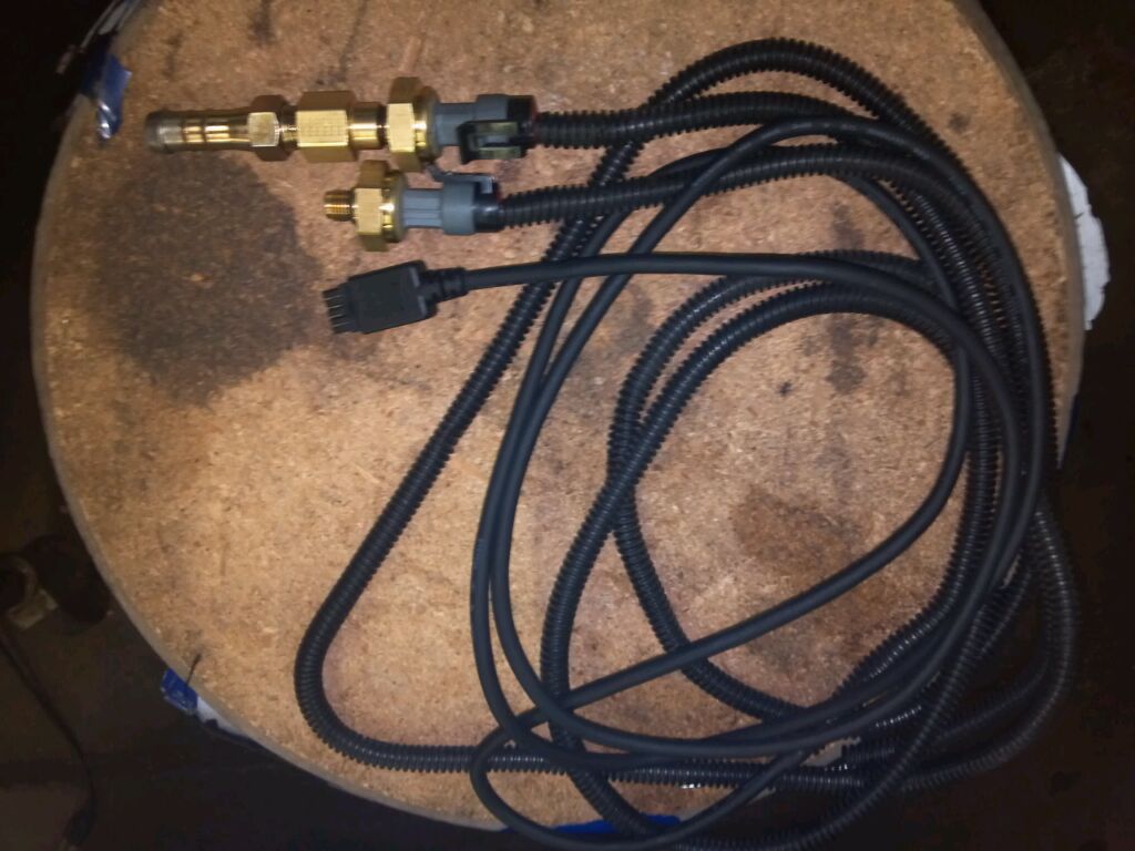

The harness does plug right into the dashdaq. We sell the harness for 200. Which is quite a bit cheaper than getting mechanical gauges.
Here is the harness.

Only issue I see with plugging this harness and Dustin's other harness into the dashdaq is the amount of ports needed. Be great to capture all the data from various locations during the same run for accuracy sake.

does the harness plug right into one of the ports on the dashdaq?
And btw that filter you posted is a little more of what id expect people with any kind of turbo set up to be running... Hopefully when I do a custom set up, I can make the atmosphere turbo either over a little further towards the fender or angled a little more so the filter and intake tube can almost come straight out.
Yeah plugs in and some inputs need to be made about a 30 min install ddepending on what you are doing.
The problem with that is the dashdaq only allows two external inputs at one time. I wanna build a similar harness for the edge cts since it allows 10 external inputs.

Is that extra map sensor a map sensor for monitoring boost on the low pressure?
You can use it to.read manifold preassure over 60 psi, low pressure Turbo boost
Turbo inlet pressure
I can also set them up to read temps too
Problem is without an additional module you can only add 2 sensors
What would be awesome is if we could get a tuner to relscale the factory map sensor to except say a 8 bar map sensor to read 100 psi. Eric said it's not that easy to do tho.

So I could use the harness to see how much boost each turbo is putting out to tune a waste gate around the high pressure turbo and into the atmosphere? Or no?.. either way it seems like a good tool.
