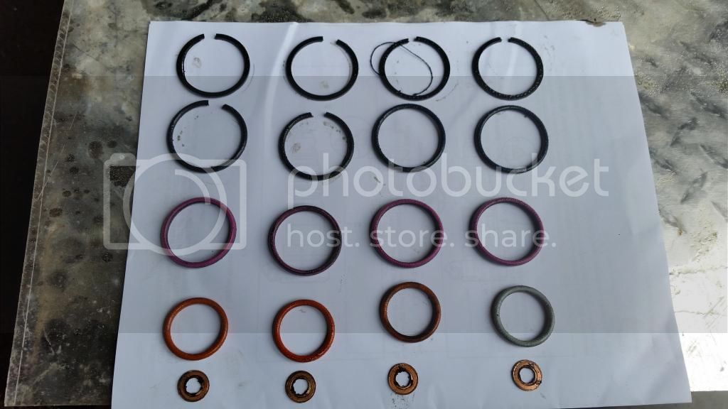

I did my passenger side o-rings this afternoon. This is what I pulled out.
So between the driver and passenger side, I had a total of 4 total top ring failures. How is it possible that the motor was still able to run and build ICP? Once I got the motor started, it had full power, no smoke, nothing. Is it due to the different HPOP that was able to supply HPO?

That sucks. What is up with the different color on the lower Oring on the right?

Werent you having trouble starting it? That would be the HPO struggling to build. Then with a break in the seals, it could get air into the rail while sitting . Once the truck was running, the pump supplies enough volume to build decent ICP.

Yes I was having trouble starting it. I would extended crank then it would start at all. Without the assistance of ether, the motor would just crank. I did not want to keep cranking it because I would kill the batteries and possibly the starter.
Once it ran, there had to be a massive oil leak in the HPO system. I was able to get 3000 ICP and saw 3600 once on the ScanGauge.
