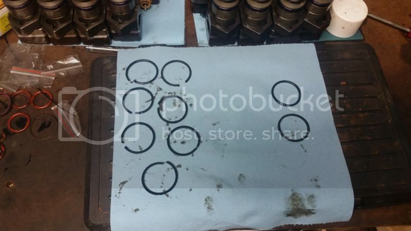

I did my passenger side o-rings this afternoon. This is what I pulled out.
So between the driver and passenger side, I had a total of 4 total top ring failures. How is it possible that the motor was still able to run and build ICP? Once I got the motor started, it had full power, no smoke, nothing. Is it due to the different HPOP that was able to supply HPO?

crush washers loom like hammered chit too!
