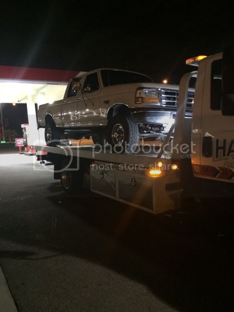

Looks like mine are shot too. Dead in the water. Hopefully tear into this thing Saturday. Waiting for a tow truck.........

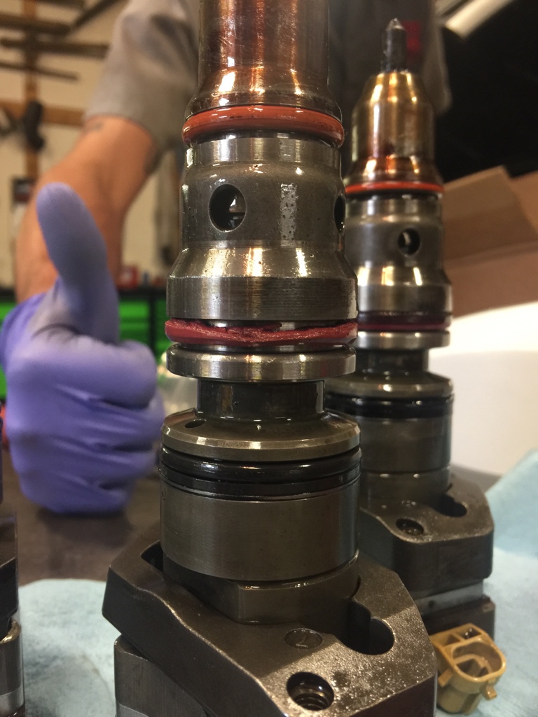

We had the same problem. Tim said there was a bunch of bad "o" rings out there. I replaced all of them with Alliant, no problems since!

Yep, I did the double metal ring. I staggered the joint 180° apart. Wit the doubled the metal ring, you eliminate the gap in the upper groove. And when installing the injector, it has a tighter fit.

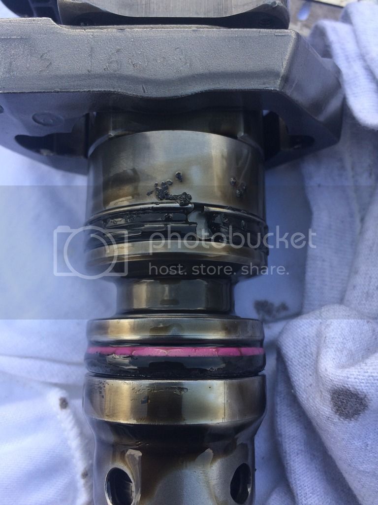

I found the missing copper washer on the ground. The missing parts of the o-rings are eveywhere!

This was the worst injector.
All of the injectors are reinstalled. It sure is tough to seat them all of the way with the extra metal ring in there. Just need to finish replacing the leaking water pump that I found while I was in there. Then I can fire it up.
