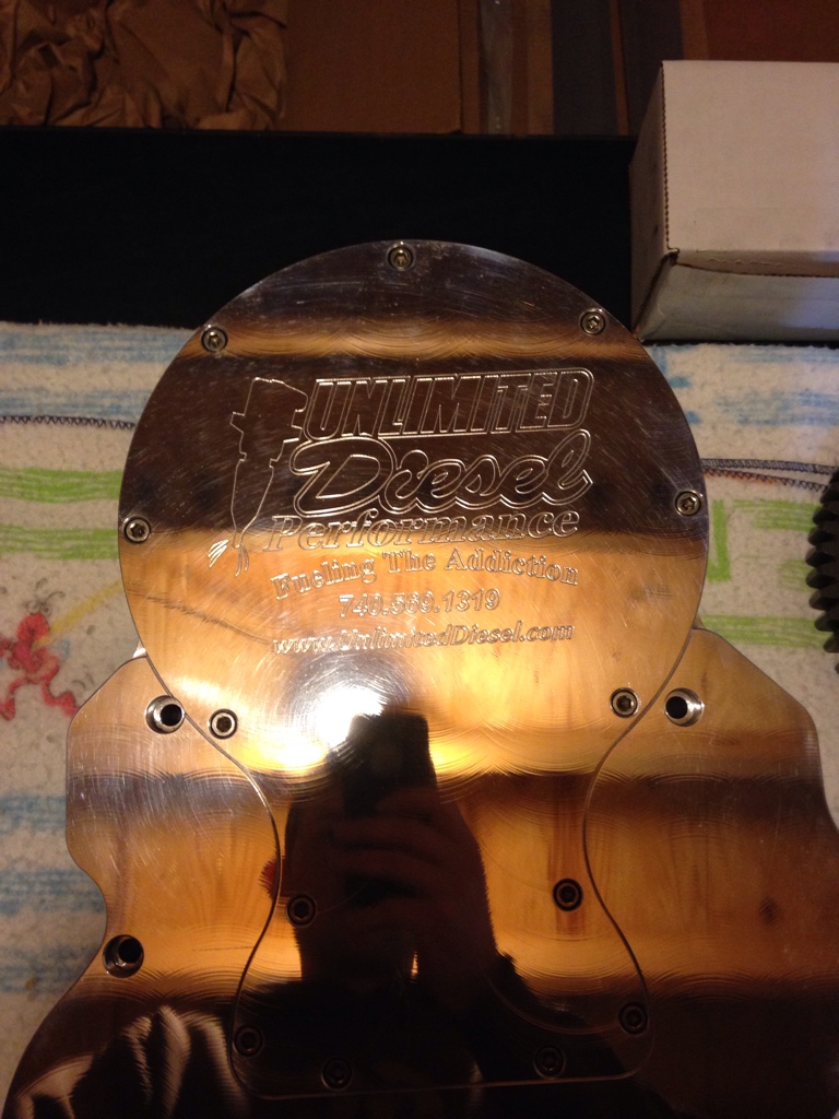

Got some important parts today. Big thanks to craneman and Nate at Unlimited Diesel.
