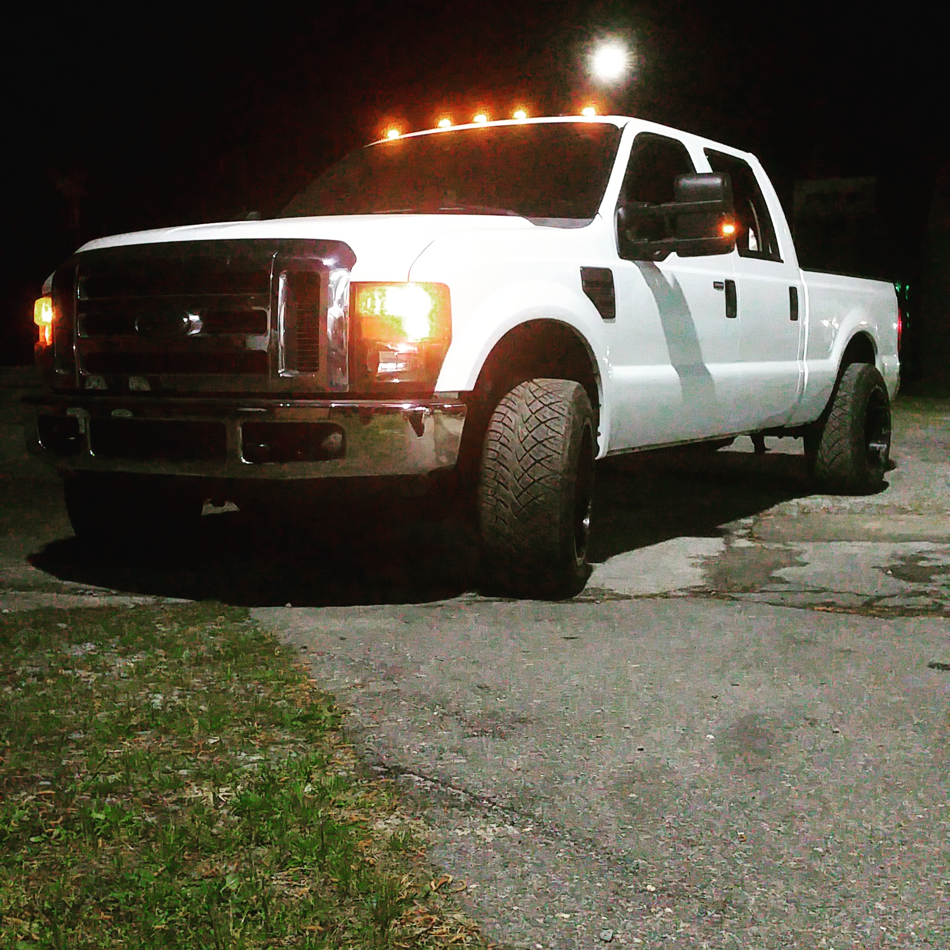

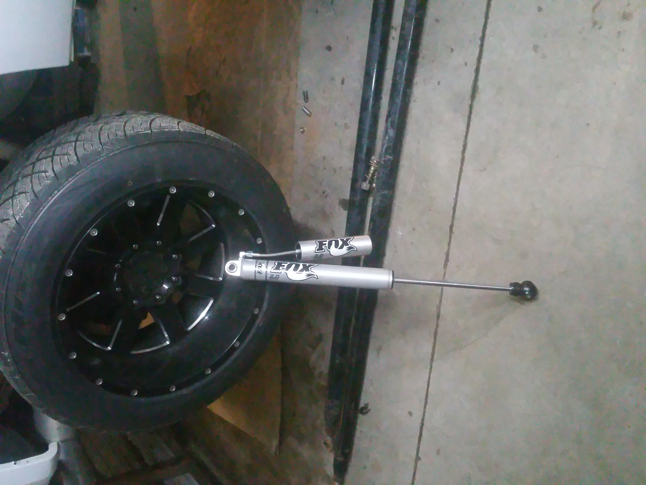

Finally got this whore lowered. No rear block, 4800# coils, fox 2.0 resi, and 420s. Just in time for Rudy's. New Trac bars going on soon.

How do the resi's ride and what shocks did you have before
Ride awesome, feels like I'm driving an SUV. Soaks up all the imperfections on the road awesome. Had a 4" lift with some bs rancho shocks that were at the end of their road.
Bigrpowr recommended resi mounts with no rear block and lighter duty springs for ride quality. She rides like a Cadillac.

im very interested in going that route. Whered you get the springs

My buddy runs a shop, and ordered all my stuff, I'd have to ask him, then I could pm you. I know for most part the springs are straight from Ford. I believe the vendor on here- sunrise Ford can get you a competitive price as well from what I've read. They're only a couple hundred bucks. Bigrpowr likes the 4400# springs, along with others. I chose the 4800#. Might grab a set of 4400# just to try out. Can't go wrong either way.

Yea from what ive found they are about 100 bucks a spring. That was another question what the difference in the 4400 springs would be compared to 4800

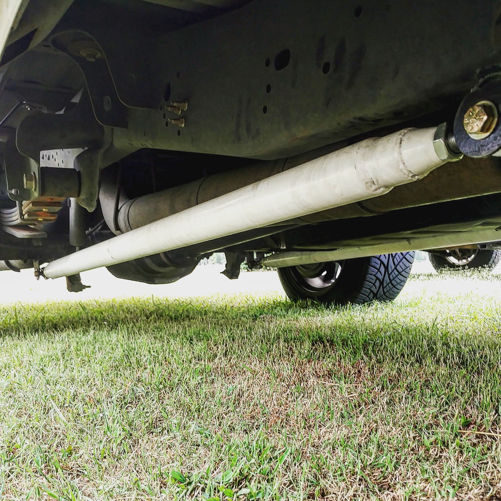

Finally had my traction bars installed. Fresh powder coat, new mounting brackets, and heim fittings/misalignment spacers etc. Also had my driveshaft balanced, and spicer u joints installed. Truck is finally where it needs to be, and ready for a couple passes.

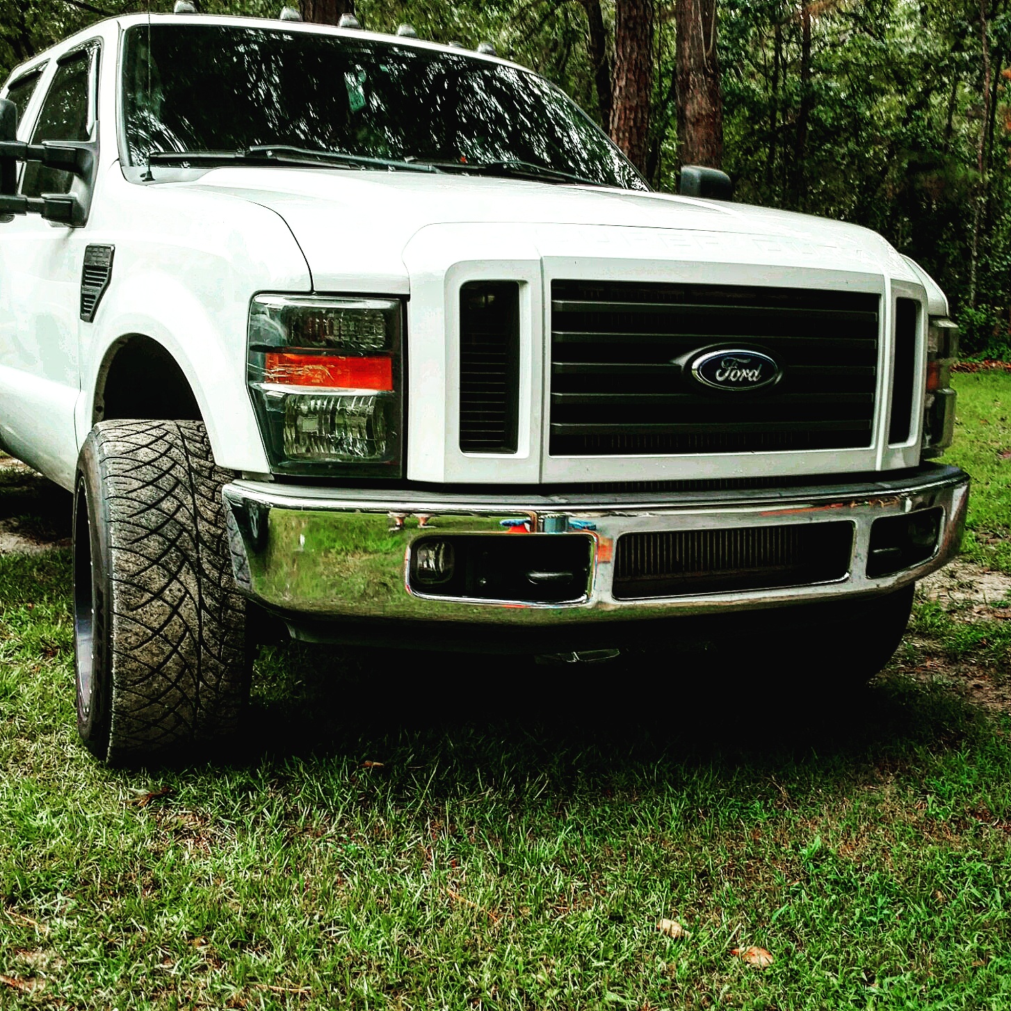

Behind the times, and nothing special.....
But she looks a lot better with a new grille.
