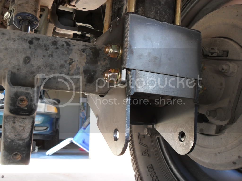

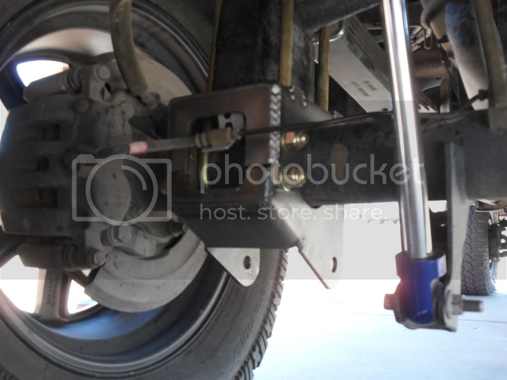

Trevor are you just doing joints only on one end now? What joint is that on these last pics?
NotStock
1,274
Tucson, AZ
Still using a poly joint on the axle side same as before, the housing is simply welded to the bar. It allows the gusset to be apart of the endlink and makes for a stronger joint. The joint on the frame side is a johnny joint with poly races to allow articulation and still absorb road vibrations and noise.
Homesteader
May 26, 2011
610
Where does the poly joint go on the axle side in the short tube? On the frame side you are using a Johnny joint what about the Ballistic 3" joint that you mentioned earlier? Is the Johnny joint a better option?
NotStock
1,274
Tucson, AZ
Ballistic is the company that makes the joint. Its a johnny joint design. The poly bushings fit inside the tubing that is pictured.

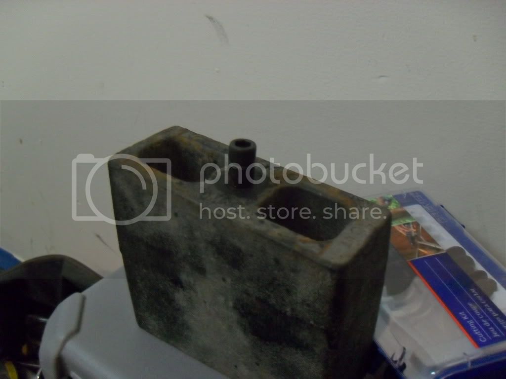

Had to drill and tap for the supplied Allen head bolt, to act as an extension for the "nipple" on the lift block, wasn't too bad, just be sure to drill directly in the middle as possible

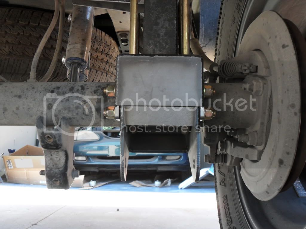

Then I got the rest of the pieces cleared coated......for now, I really like Trevor's work, so decided to leave it raw but protected. Took the axle and leafs apart so I could sandwich the plate and bolt on the bottom plate. Holes lined right up the first time, pretty impressed
Gonna have to drill and tap some small holes for the brake line mounts but no big deal

I would have sandblasted before clear coat to remove the mill scale if you lke that look. I like that rear mount.
