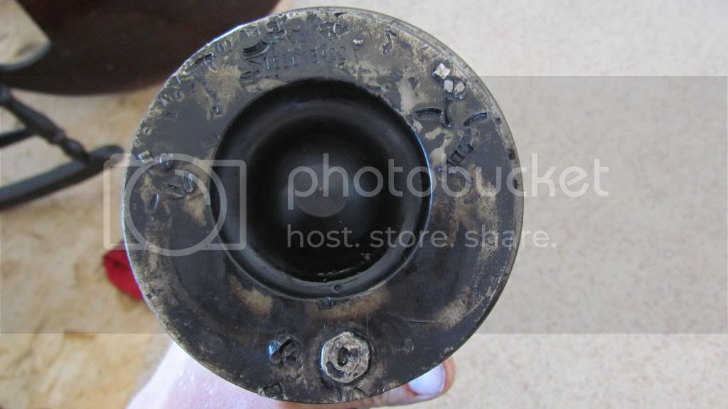

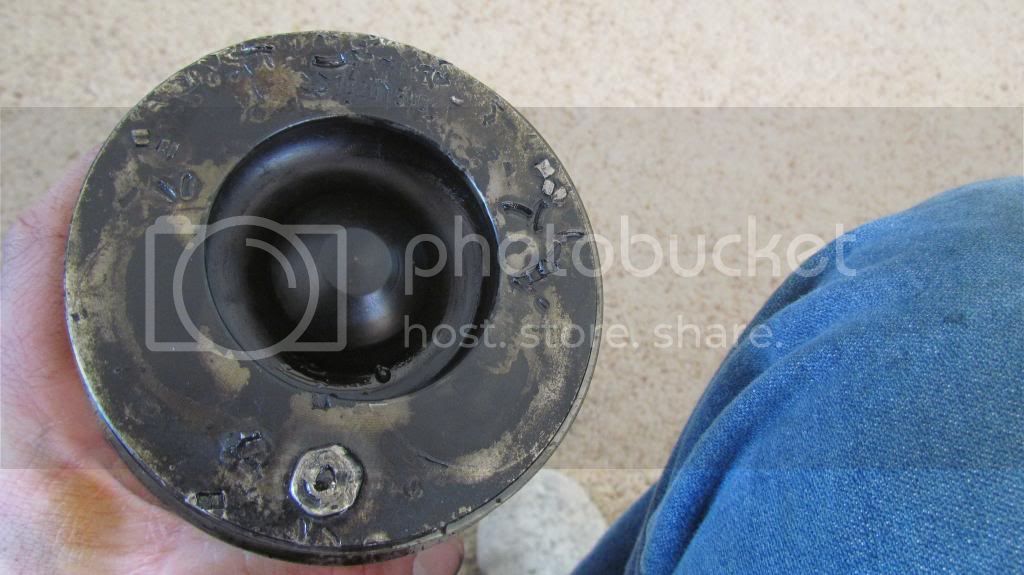

I got time to work on the pickup and here is the deal.. The head and valves are great not a thing wrong with them.... The piston well that is another story..
Here are some picture of what happen when you get in a hurry... I will say this IF you ever drop a not and cant find it STOP what you are doing and find it BEFORE moving on... I learned this one the hard way.........
yup no question about it..... Its a nut!
Well the piston is not cracked BUT it could.. I think I am going to buy another one for safety... I might clean this one up and see what it really looks like first.... Will see though.
any thought on this from the engine builders???

Don't use that piston! Might even consider finding another rod too.

I have another piston on the way.. First thing i did was buy one.. this piston has a hair line crack down the side next to the nut.... Does not look good!!! I would have to be on Crack to try and use that piston over again!!!!!
I have a set of forged rods i could dig into if need be...

holy ***! how are the heads fine?
live life full throttle
The only reason I can think of is the fact that the head is cast iron and the piston is aluminum.. And the aluminum was subjected to 900 to 1300 Degrees of EGTs. That right there would make it pound into the piston a little more easy..
also the nut was not a hard not. it was a self locking nylon washer with a steel casing so it was a soft nut. The head has a really light mark were the nut would hit. I am going to take the valves out and look at them though.. They seat fine as it is and open and close good. Just what is 15 minutes of work to be sure?
