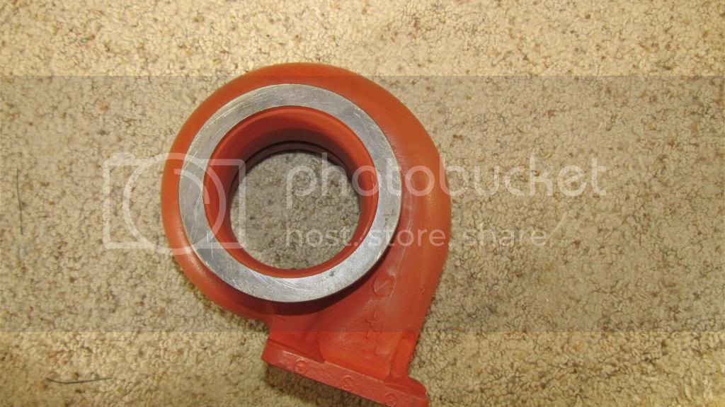

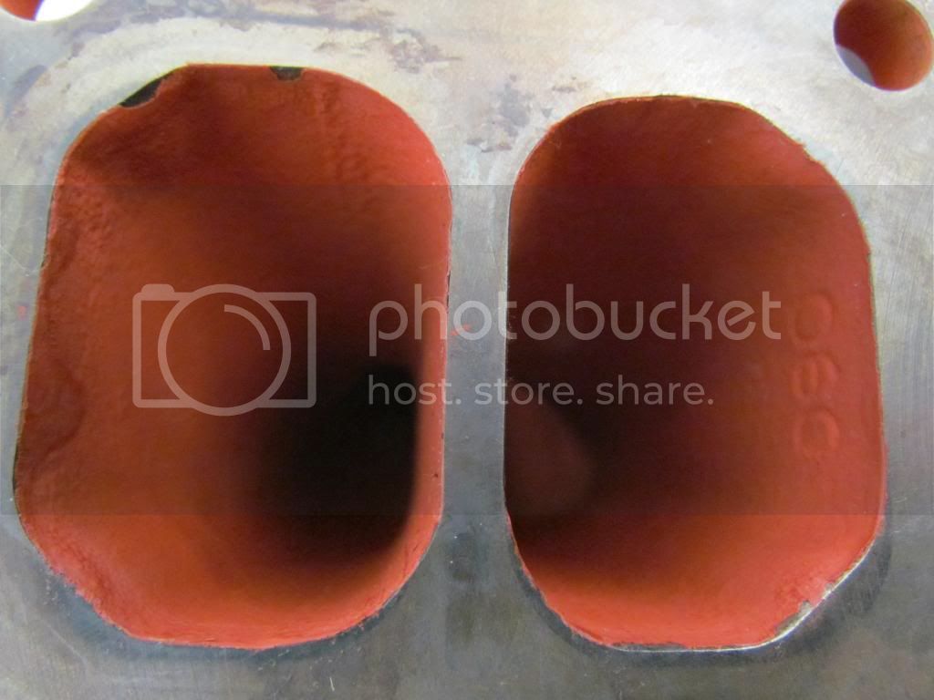

Exhaust housing ceramic coated inside and out.
Now That the engine is coming back out I might do the up pipes to. Would be nice to have it done.
