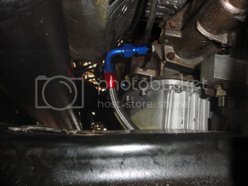

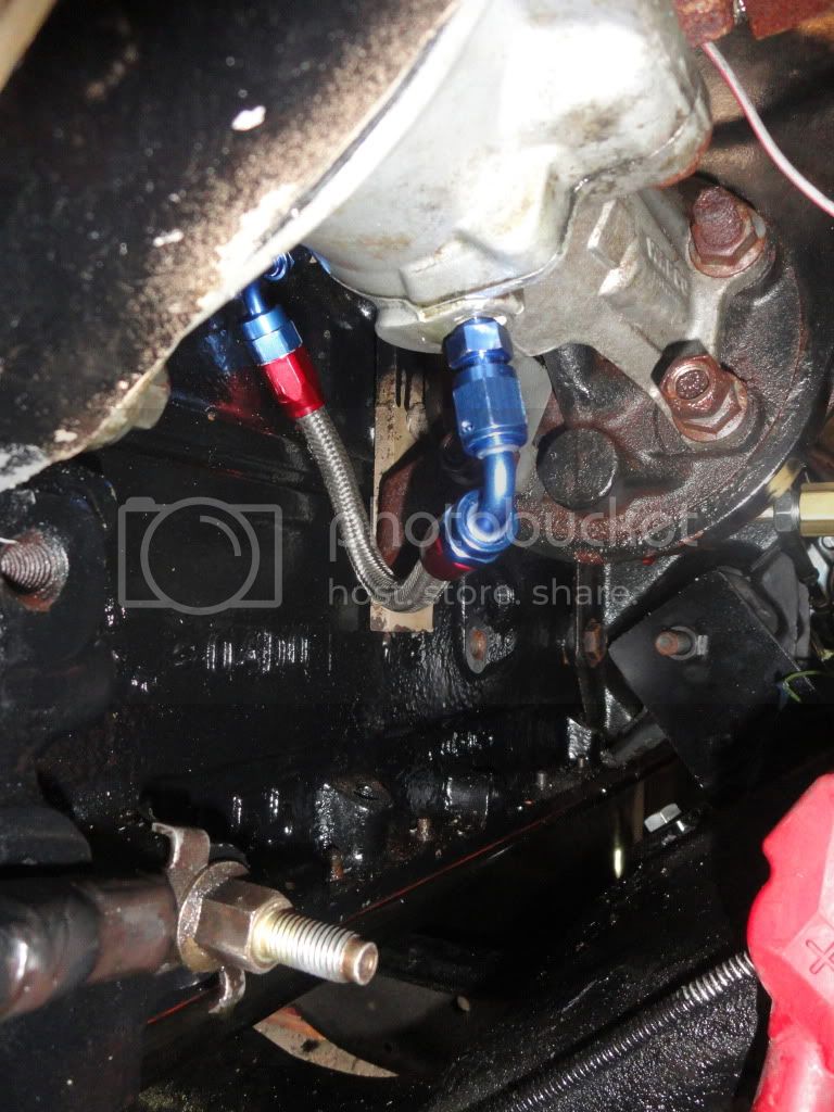

New ps/vacuum pump oil feed line

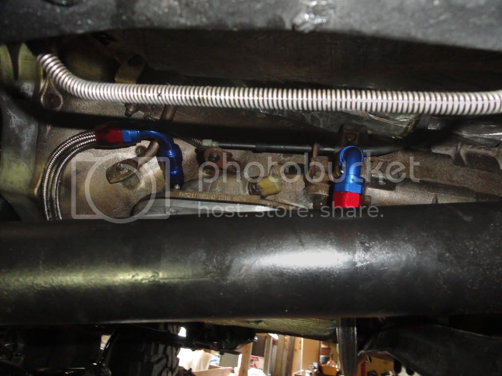

Tranny cooler lines all finished

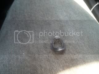

He had my governor all pulled out and showed me that one of the weights and snap rings had come off the governor and was just bouncing around in the housing, probably caught the governor and was holding it open which was one of the issues. The weight is all mangled. Good news though is the camshafts and rollers still look brand new. Plungers were confirmed to be 12mm as well and all moved freely. They are gonna put a new weight and snap ring in the pump and re seal it.

Here is a pic of the weight:

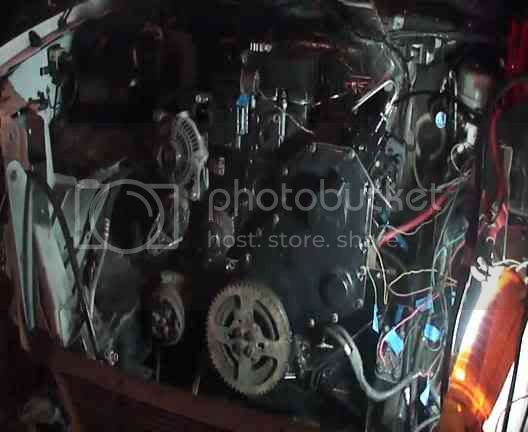

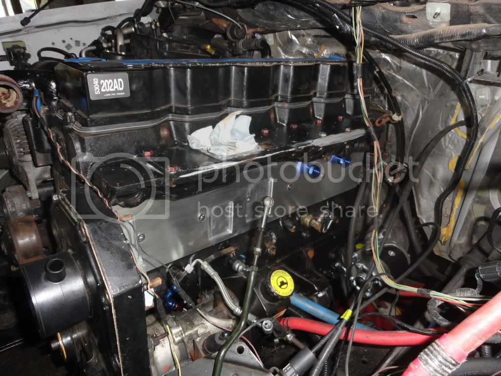

Well the Fummins is Finally ALIVE!!!!

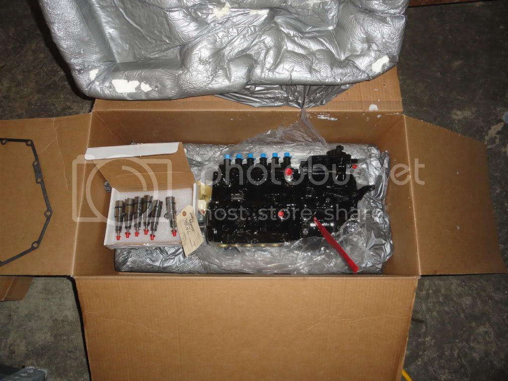

Went to Columbus yesterday and picked up my pump and injectors. The pump flowed a wopping 150cc & 1500RPM in stock form LOL but it should flow plenty when I start messing around with it. Dan at Columbus told me the injectors flow great as well.

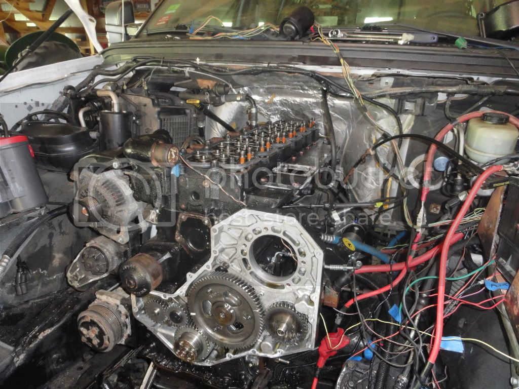

So I went to the shop today and put the engine back together and by the time Jason got home from work I had it ready to fire. So we cracked the lines and ran the airdog and cranked it over and worked the air out. After cranking for just a minute or so I closed the lines and she fired right up!
Truck builds great oil pressure and runs very smoother. Starts up right away now as well. I didnt run it for long since I dont have coolant running through it but it sounds great and I couldnt be happier right now. Been waiting for today for the last five months.
Anyways, here is a video and some pics. Sorry the video and sound arent matching up too well for some reason

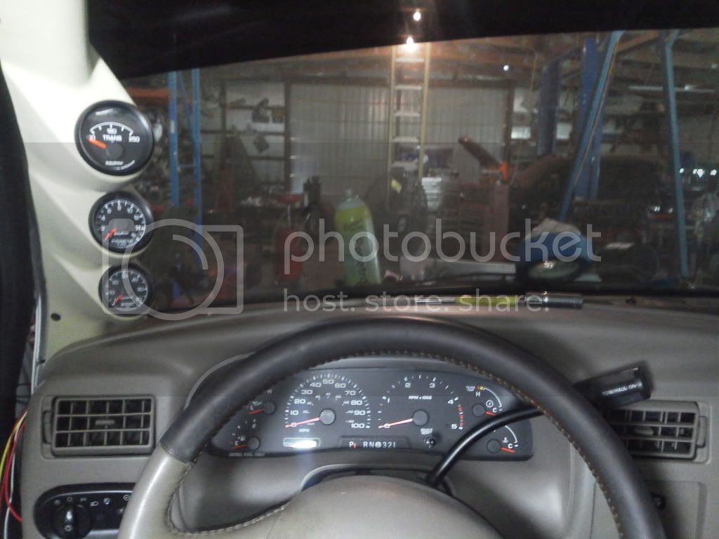

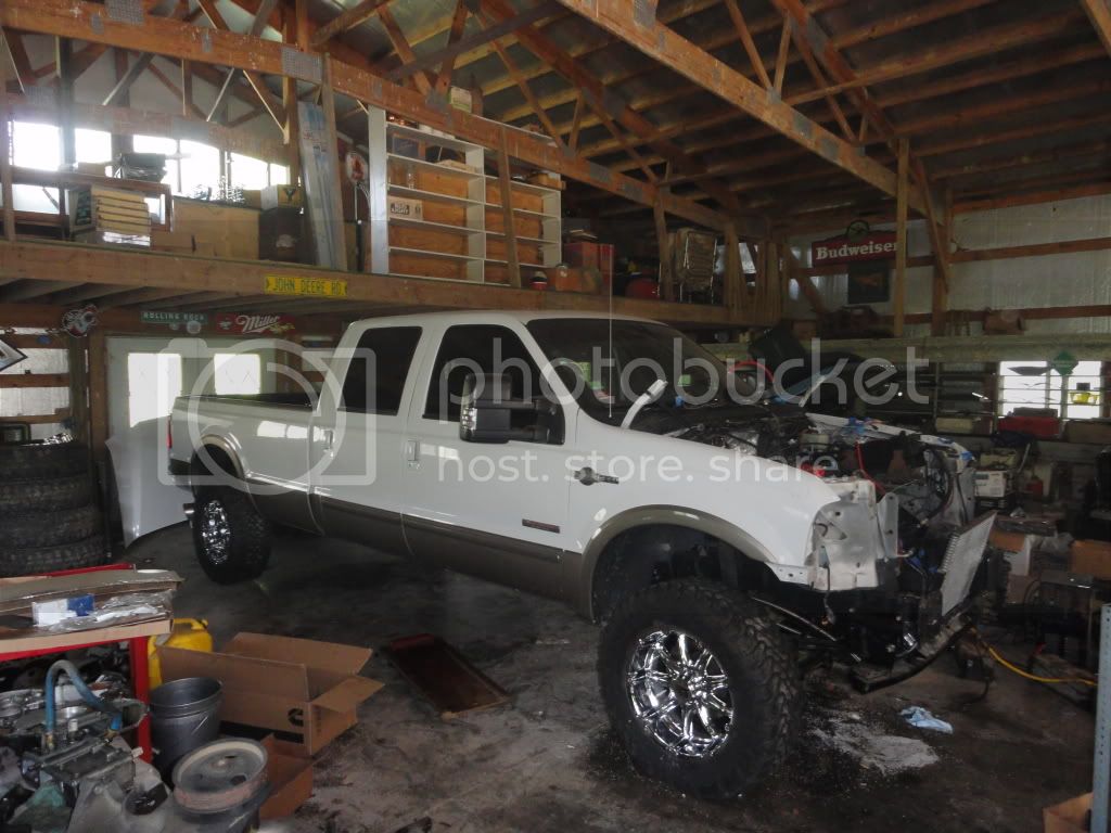

Here is a picture for you, dont mind the fact that the pillar paint doesnt match at all, it was the closest I could find on short notice and it was better than black LOL The gauges look great and I really like the quality.
Got my engine wiring harness all loomed, ran and finished. Wired up my external voltage regulator for the alternator. Started making the downpipe. And got my mockup made for the IC pipes. The hot side pipe is gonna have to have a couple 90s in it to run up and around so I can get my intake to sit where the passenger side battery used to.
Just still waiting on my new wiring harness so I can finish the tranny wiring and Id like to run the shutoff solenoid off the PCM as well. Only other issue is allowing the starter relay to trigger so I can crank the truck as the ECM can no longer see P/N but I think I can make it work if I just ground the wire that runs off pin 85 on the the starter relay to the ecm for P/N pickup. Im getting a little sick of wiring LOL Lets just hope it all works.
