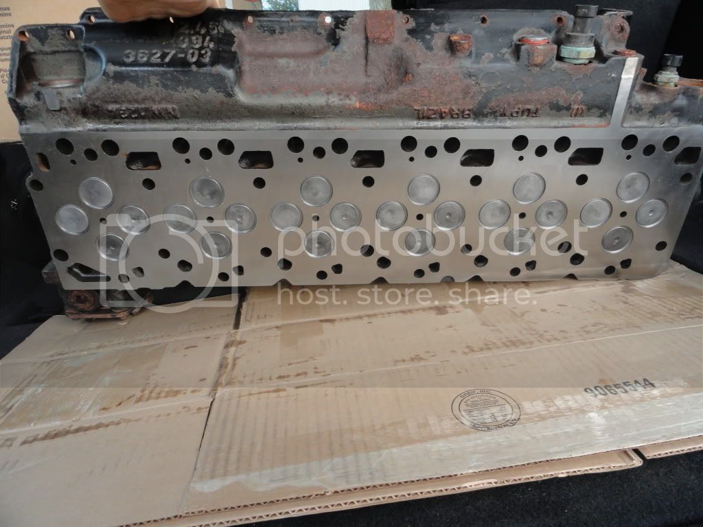

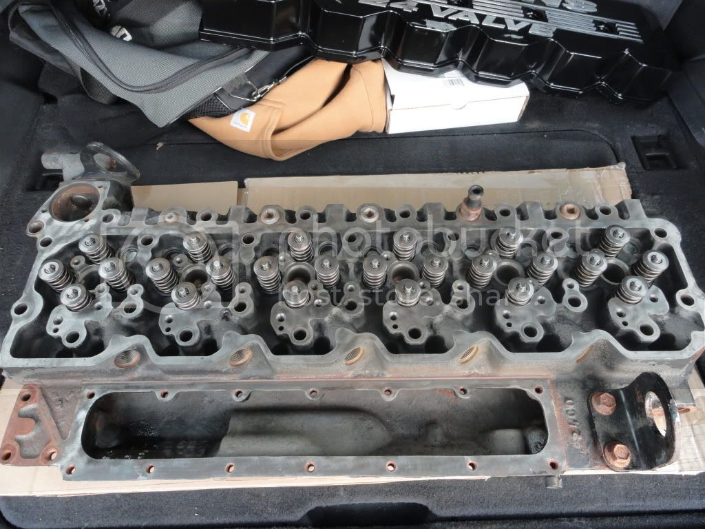

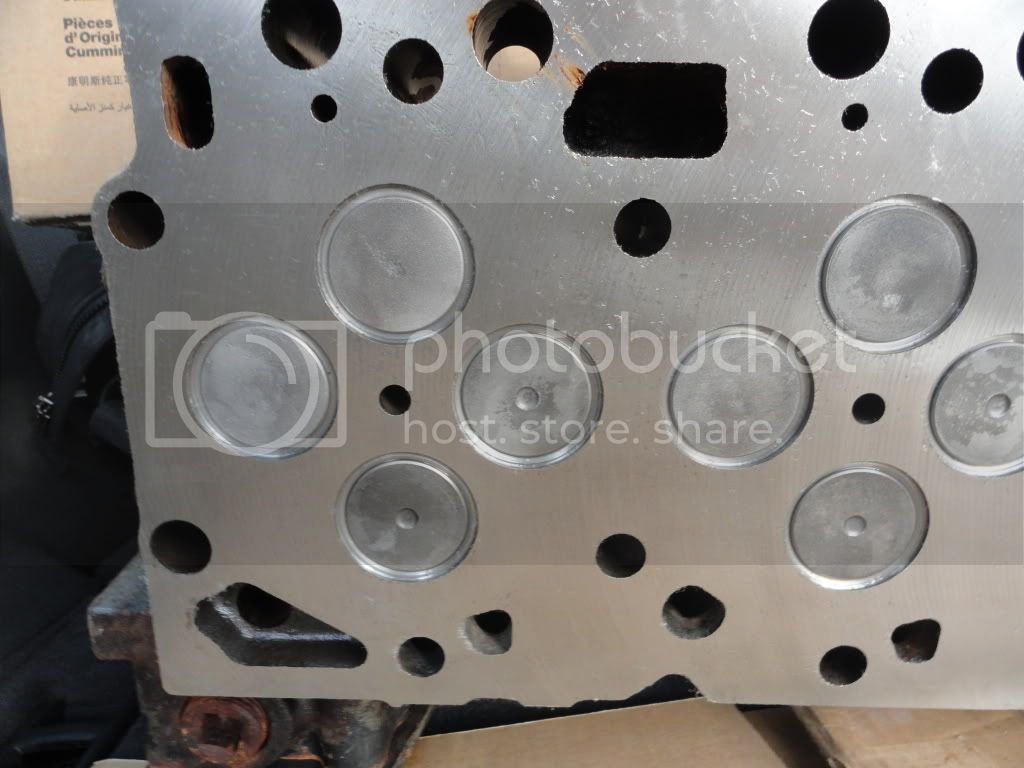

I just went and picked my head up at the machine shop and it looks great! Got my new valve guides, seals, hardened valve seats and Hamiltion 110 springs installed and the head decked. Im just waiting on my studs and it will be ready to go back on!
