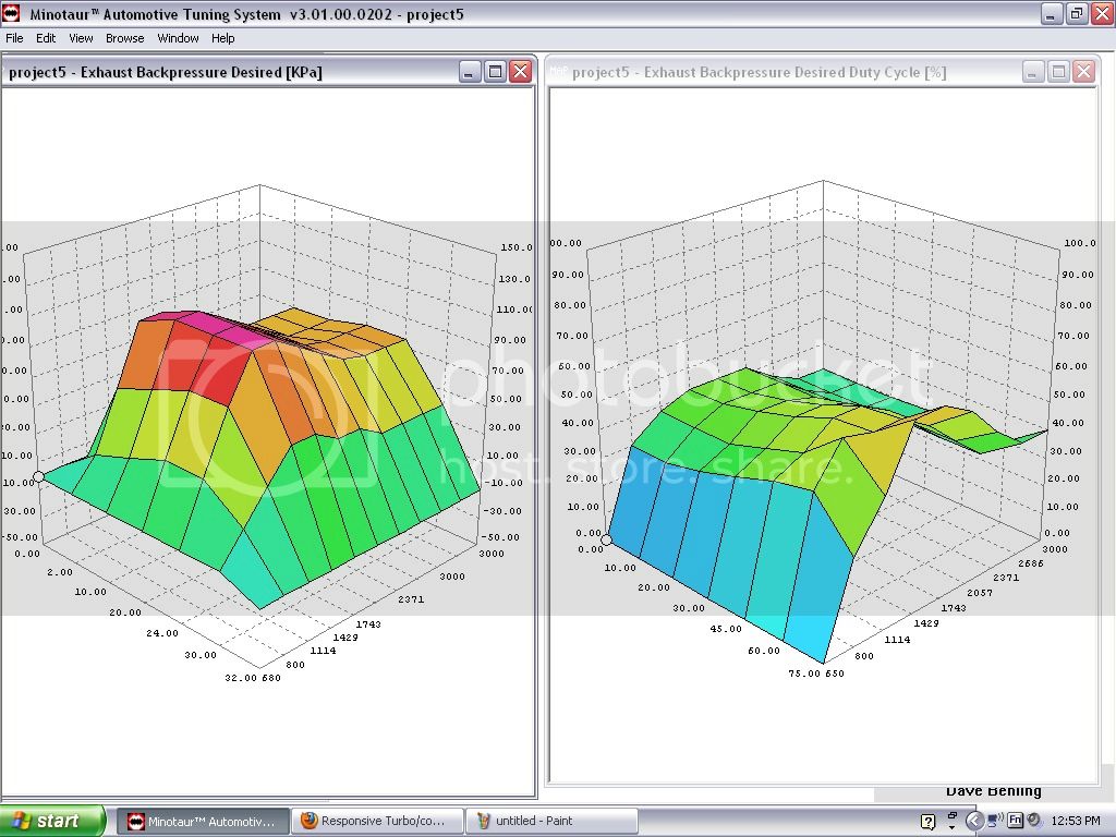

I dont think the EBPV is PWM regulated. Its either on or off. Let just say it is PWM I'm not sure what kind of control the tuners out there have on the valve. Can you build a table off that EBPV output based on inputs.
It is, and there is lots of control!
I think this is the solution!!!
