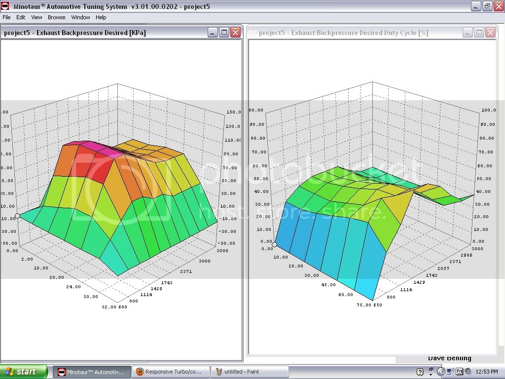

Same theory could be done using desired boost and wastegate duty cycle map...
907DAVE
May 21, 2011
2,166
AK
Either or, but EBPS would be ideal as it has no bearing on fueling. EBP can be turned off in the program so shift pressures are based on boost only. Someone just needs to verify operating voltage and this problem doesn't seem to be such a big deal.

The only thing those 2 charts are showing are what the sensors are doing I still dont see proof that the EBPV is PWM open or closed. Show me a chart that shows it open and closing.
I'm not doubting you I just cant see a valve that's meant to be open or closed being PWM.

Duty cycle means there is modulation. The valve simply does not open or close, there is many different positions that it could be in depending on a number of factors, as seen in both the maps posted.
