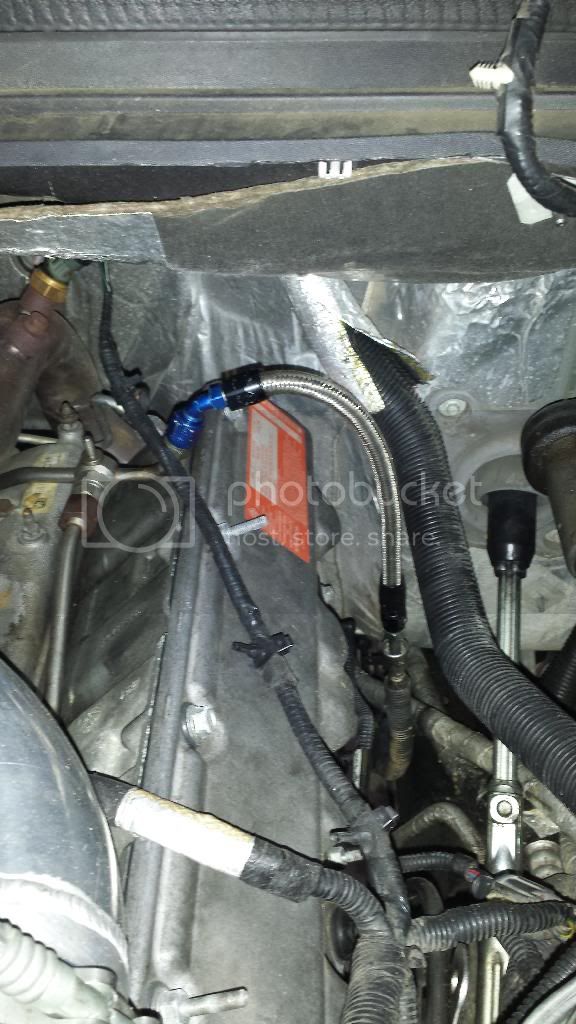

Is this the line your talking about?
08BIGRIG
Nov 26, 2011
1,814
WI
Yes that is the line. How did you get that fitting on the stock line like that?

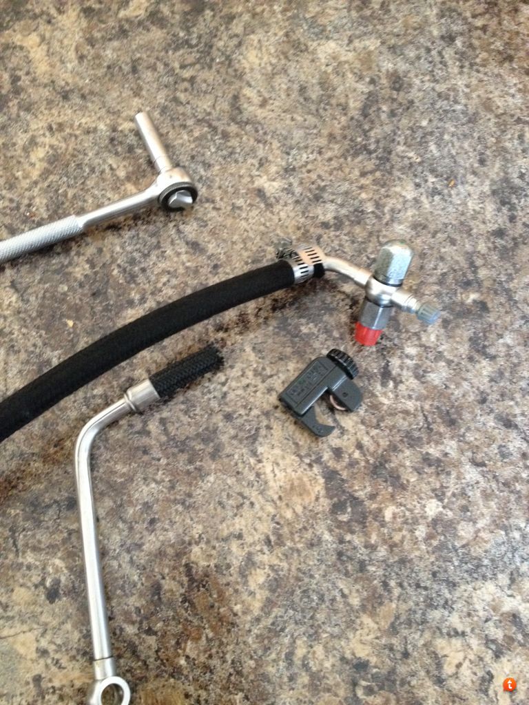

That is kinda what I was thinking about but there is not enough room there to get the tools in there with the line on the truck. I did a little experiment last night and it might be what I do if I don't figure something else out from what other peopl have done.
I took a line and cut it with a pipe cutter and then put a Parker push lok hose on it and a clamp. Capped the lines and then applied pressure with a compressor. This setup didn't leak until about 65 psi.

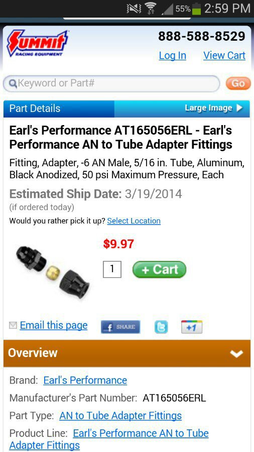

Is there enough room to use an AN to tube adapter?
I will let you know how this works out. I just ordered some of these and will be trying it as soon as it gets here. There should be enough room in there for this even if I have to bend the tube up just a little bit. Thanks :thumbup:

The fitting from Summit Racing showed up yeaterday and it looks like it will work perfect. I will be installing it tommarow.
