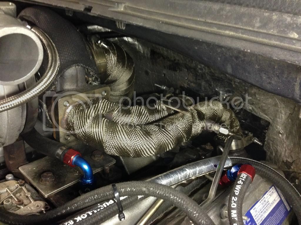

Those tube to AN fittings will work. You need to cut the line as close as you can to the end where it turns into a soft line or else you will not have the room for it. Best pic I have..

Looks very clean. On a side note, is that the 1200 degree header wrap on the up pipes?

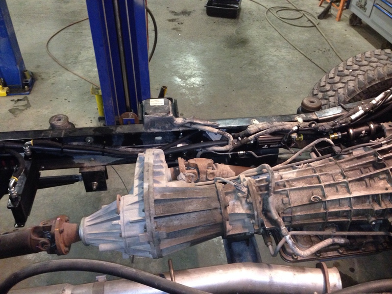

pics
This is the work that Morgan done. Its elites stage 2 lpfs with a custom cooler delete. The return is also unregulated feeding a cooler underneath. So far I'm pleased with the kit, it is very clean and thought out.
