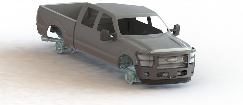

i saw the rendering but i would like to see it on an actual truck
Also why not just take the grill off and make your bumper and grill take up that space LOL would look clean like that

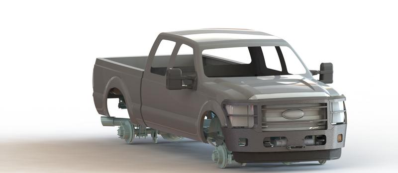

This is a slick project. Can we just take a minute to marvel at the rendering software you're using?! :eek: I think I need to get my hands on that lol
And I agree with what others have said, love the design as a whole, but I'd just take out the two center grille bars and it'll be spot on. The newer headlight hoop design is on par too.
Excited to see how this comes together. Looks like some good old fashioned fab work! Keep it up man!

Program is Solidworks

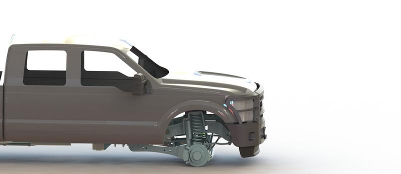

Fixing those headlight guards made all the difference in the world bud. It really had a depressed look in the first pictures but I really like the mess out of the new renderings

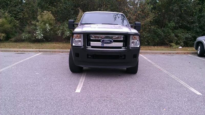

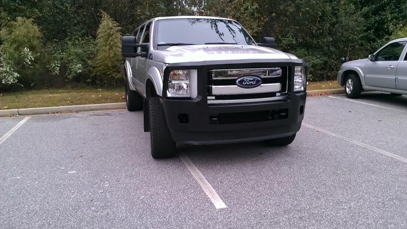

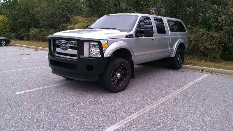

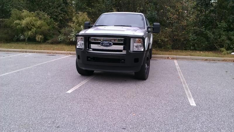

I don't like it in black. Just too much. Needs to be painted to match the truck just like I thought. My dad was coming to visit for the first time and I 'had' to have it done. Powder coat was the only one who had time so that's what it got.
Also we got a little warpage of the panels, combined with working the edges a little unevenly and things are pretty wavy. I'm taking it to a body shop this afternoon to look at smoothing things out with some filler. Even the places where the ribs are welded from the backside show a little.
I think fixing this up with a little body filler would be easy, but they don't really have fillers for powder coating. It's going to be tough in production to deal with that, but we'll figure it out.
All in all, I think it came out pretty good for a prototype.

vcassens
Jun 22, 2011
2,343
Godfrey,il
The next one will be the winch version with the slanted hoop and 'question mark' headlight protection.
wow that looks good

Should've left it raw and clear coated it that would've been pretty cool.

I'm still not completely thrilled with the center two bars. Maybe one would be better, even if it does block the Ford emblem.

I like it. Can't you render in some jack stands or wheels though!? Kills me sittin on the rotors LOL

Following the flow of the headlights looks amazing. The headlights and mirrors are what make these trucks IMO. Just like when people go from pre 08 mirrors on pre 08 trucks to 08+ mirrors on pre 08 trucks. The mirrors match the same contour as the headlights in the pre 08 trucks. I understand their point in doing the swap as the FOV is a lot greater in the 08+ mirrors and it doesn't look terrible but I think it looks better with the factory ones that matched the headlights
No bars leave it open like the first one you made. Or if you do put bars make them thick, those skinny ones look so out of place.
CT9AIX
May 5, 2012
1,048
MA
The small center bar is too high up and too close to the top main bar. Maybe try getting rid of the top small bar, centering the lower bar and making it thicker even though it will prob cover the ford emblem. Or do away totally with the horizontal bars and make two thicker vertical bars that straddle the emblem.
