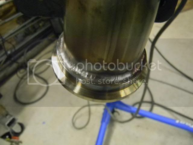

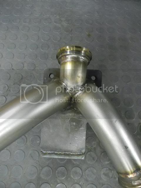

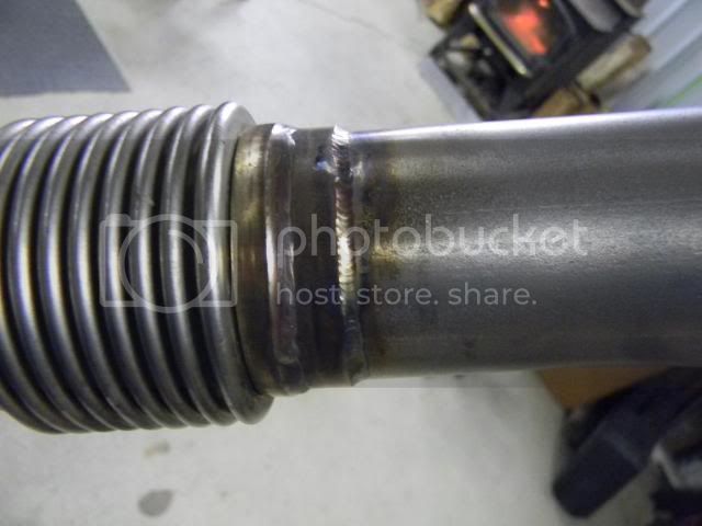

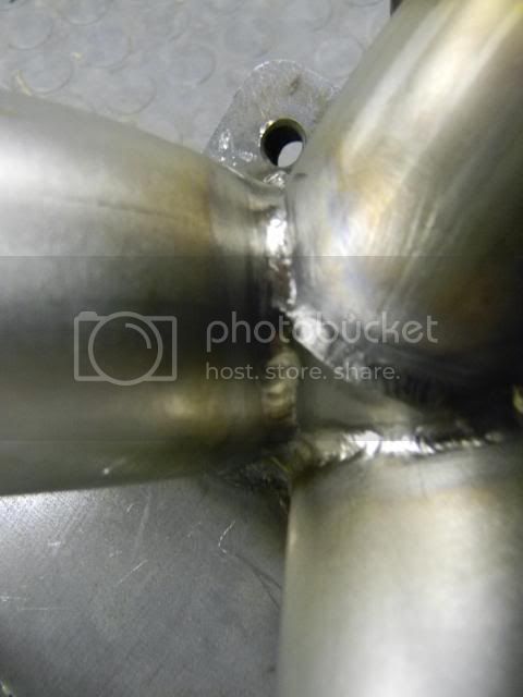

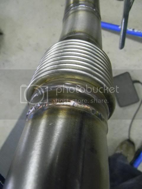

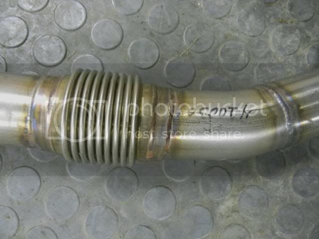

Here are some better pics of Tig welded up-pipes. Just received the others back on Friday and will clean up a couple spots on them.

Not the greatest welds ever, who ever made those used a mig welder instead of a Tig welder. Hope you didn't pay much, I wouldn't worry what the welds look like as long as it doesn't leak. Although you would expect for the welds to look a lot better.

Hell no!!!, the first set the guy posted. The ones on here that worstenemy453 posted aren't mig welded, those are tig welded, thus the diffrence in quality of the welds. when the welds look like a roll of nickels, thats some good sh*t man. Honestly i just saw those new pictures.

Saturday I received my up pipes back after being corrected, hahaha Im thinking he needs to invest some time into some welding classes or maybe out source welding to a real shop . Maybe someone forget to put the voltage knob on the welder or it's a cheap taiwan junk, these welds look like total ass!!!!!!!!!!

The welds were smoothed out! Not sure what you want? They will NOT leak!!! They are still mig welds, the starts were smoothed out on the tig machine. If you looked inside of the tubing than you can tell there is obvious penetration. It doesn't take much heat to weld an .065 wall tube. I guess 200 amps could be used but there wouldn't be much left of anything!
